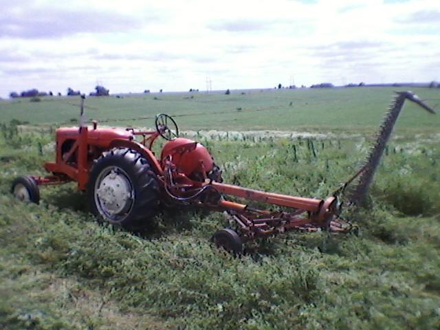

I was out with my 1950 WD today mowing hay. The mower is a Allis Chalmers Number 7 trailer mower. It does pretty good for the most part.
This was the first cutting, I could not get to the hay sooner because of my schedule or rain.

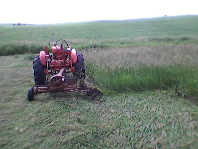

It does pretty good on grass. See below.
The Alfalfa was down a little bit. So there was a few challenges.

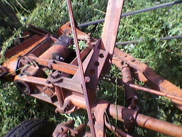

1. It plugged once in a while. I found by adjusting the angle of the sickle this helped. See the photo below. I set it so the sickle is pointing up a little.

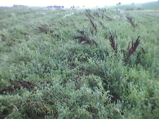

2. I need to come up with a better sweep on the end of the sickle. It works great in tall grass. But in Alfalfa it is hard to see where you have mowed and it seems to clump on the end of the sickle. I am looking for suggestions. The photo below is what I see when I am going through the alfalfa as you can see it is hard to see where you already cut!

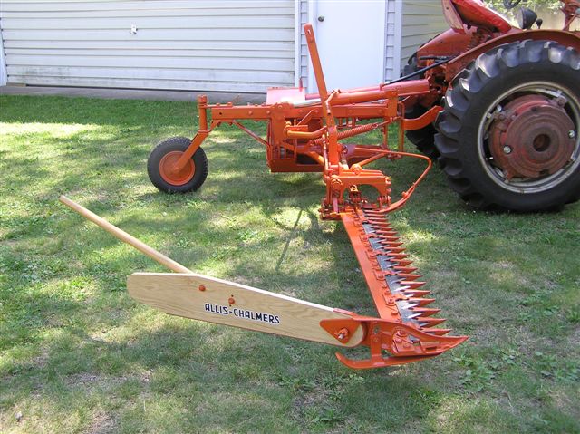

Jim Lux is going to bring me a deflector board and grass stick to try. The one on it is metal.

The deflector board like this one is the one I think Jim is bringing me to try.
