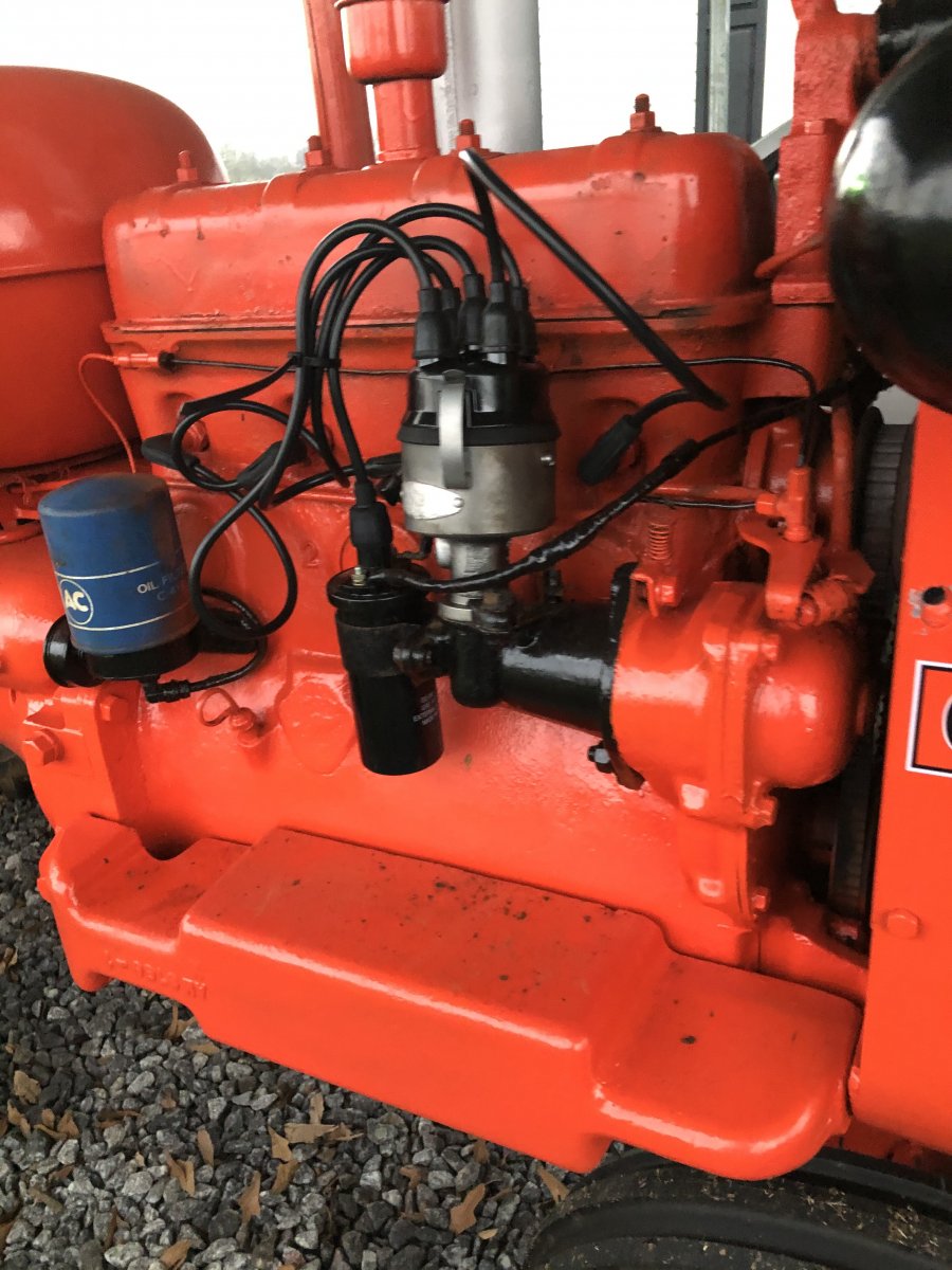

I've been told so many different things about the distributor/ magneto.    I want to replace the mag with a distributor, what will work?

Yes, it will work, but you will need the correct drive and housing along with the distributor itself. I sent you a PM
Points: 90676
Post Options Post Options   Thanks (0) Thanks(0)   Quote steve(ill) Quote  Post ReplyReply Direct Link To This Post Posted: 26 May 2023 at 8:52am
when you remove the MAG, you notice that it is not a gear drive.. It has TWO TANGS that drive the shaft... That is what you are looking for.. Something off a B, C, CA will all work... looks like this on e-bay.

Steve above has listed ONE way to do it, you also can do it with another setup. Steve has listed the magneto conversion style, there also a factory setup with an extended drive gear setup that was used on CA's and a similar setup on d14/d15

   i  have to ask why ?  did your mag quit?  you will have to rewire  your tractor

We offer a Mag to distributor conversion kit. Gives you everything you need to do the deed except ambition. New wiring, key switch, choice of coils (6 or 12v) new spark plug wires, plugs, installation instructions, rebuilt drive, rebuilt Distributor top to bottom. Available with points or with electronic ignition. Visit our website. Our P/N's- 1511B-01 points version, 1511B-02 Electronic ignition.
