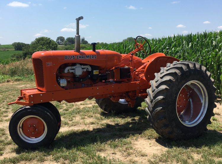

Well here’s the results!!
And I love it!!
Pulled it out the first time with all new paint.

Post Options Post Options   Thanks (0) Thanks(0)   Quote ac hunter Quote  Post ReplyReply Direct Link To This Post Posted: 05 Jul 2021 at 3:15pm
     Looks great. A nice reward for all your work. Hope you enjoy driving / showing / whatever with it.
Points: 8661
Post Options Post Options   Thanks (0) Thanks(0)   Quote Sugarmaker Quote  Post ReplyReply Direct Link To This Post Posted: 06 Jul 2021 at 4:47am
55,
 It looks right at home! Your going to like having it around!
Tires make it look ready for some serious work too! Decals look good!
Thanks for keeping us up to date!

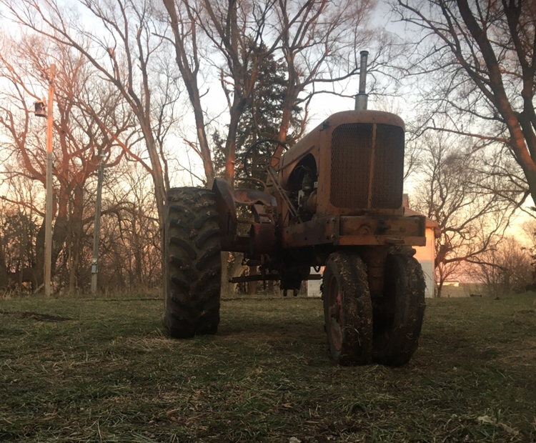

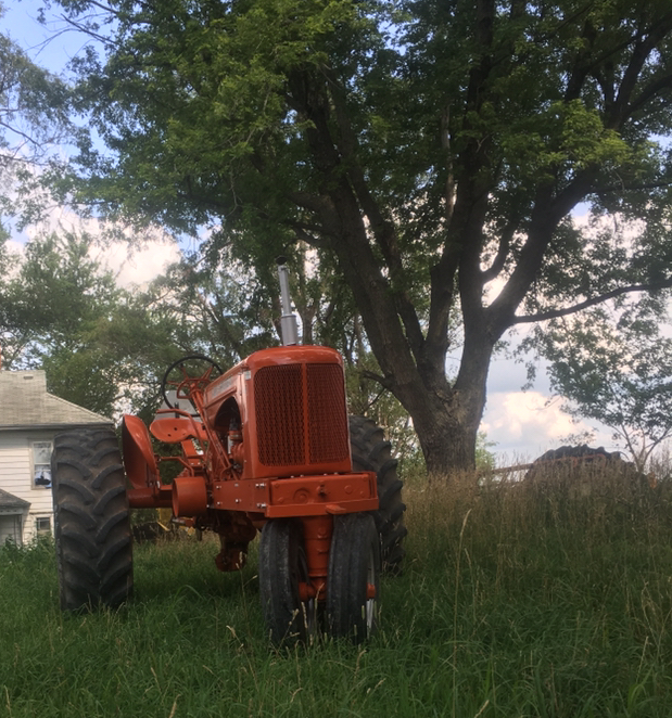

Here’s a picture of it before and after.

Well I found a wide front for it!!

I put a wide front on it the other day and here’s a picture of it...
IBWD MIke View Drop Down
Joined: 08 Apr 2012
Location: Newton Ia.
Points: 4282
Post Options Post Options   Thanks (0) Thanks(0)   Quote IBWD MIke Quote  Post ReplyReply Direct Link To This Post Posted: 28 Jan 2022 at 8:51am
Nice!
