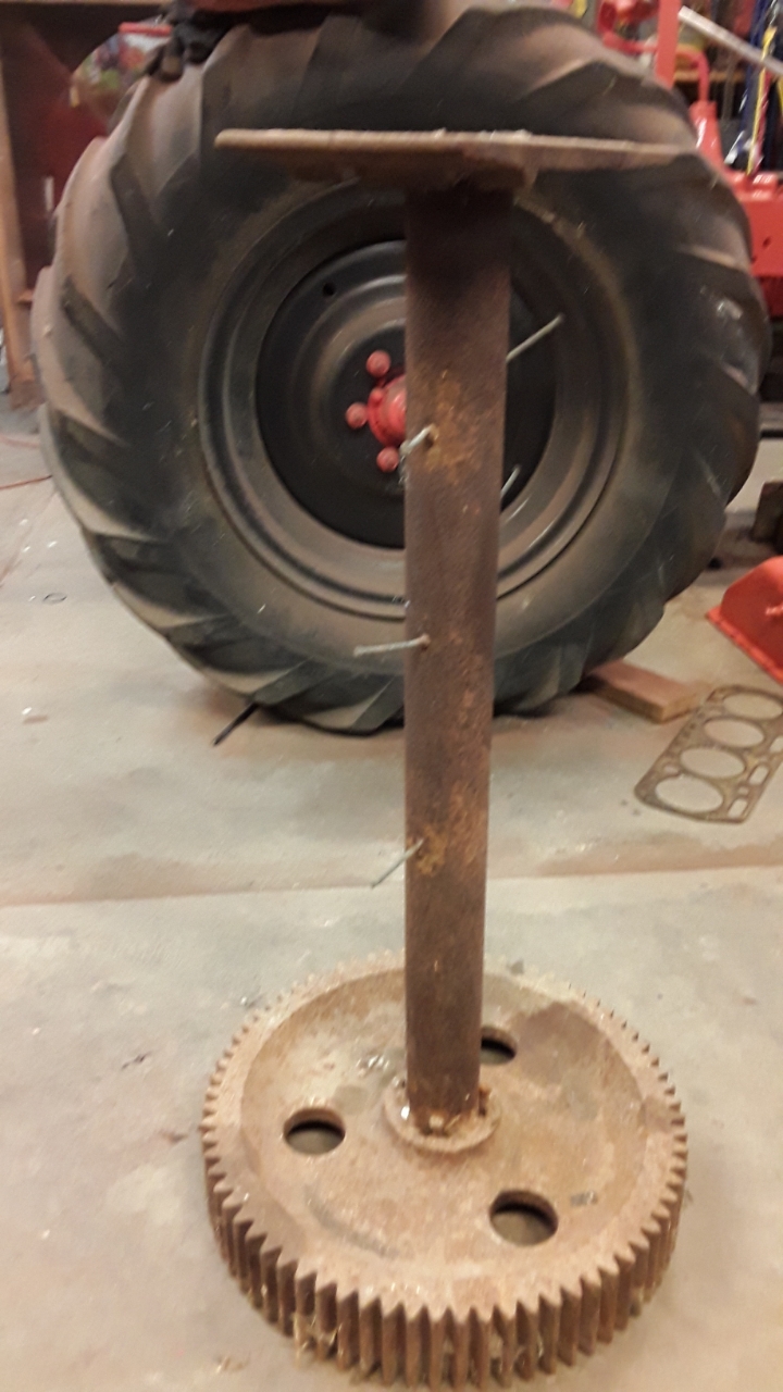

I know this is a bad picture, but are these factory rims? And where could i get a set like these?
Thanks Randy

Randy, I'm not sure if those are factory rims or not. They might be the early disc wheels which still used the 11.25 X 24 tire. Any pictures I've come across always show the early disc wheel with a wheel weight attached. The 28 inch rims came out after tractor number 81757.

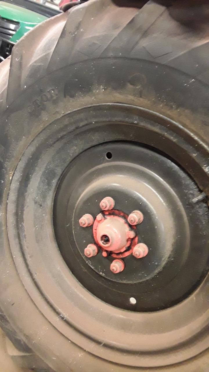

The tire is a 13x24 inch tires. He is a better picture. The owner wants to know if i can find new rims for it. I might have to patch the rot in the rims.
Thanks, Randy

You might have to repair those ones.  They are deep drop center rims and pretty hard to find.
