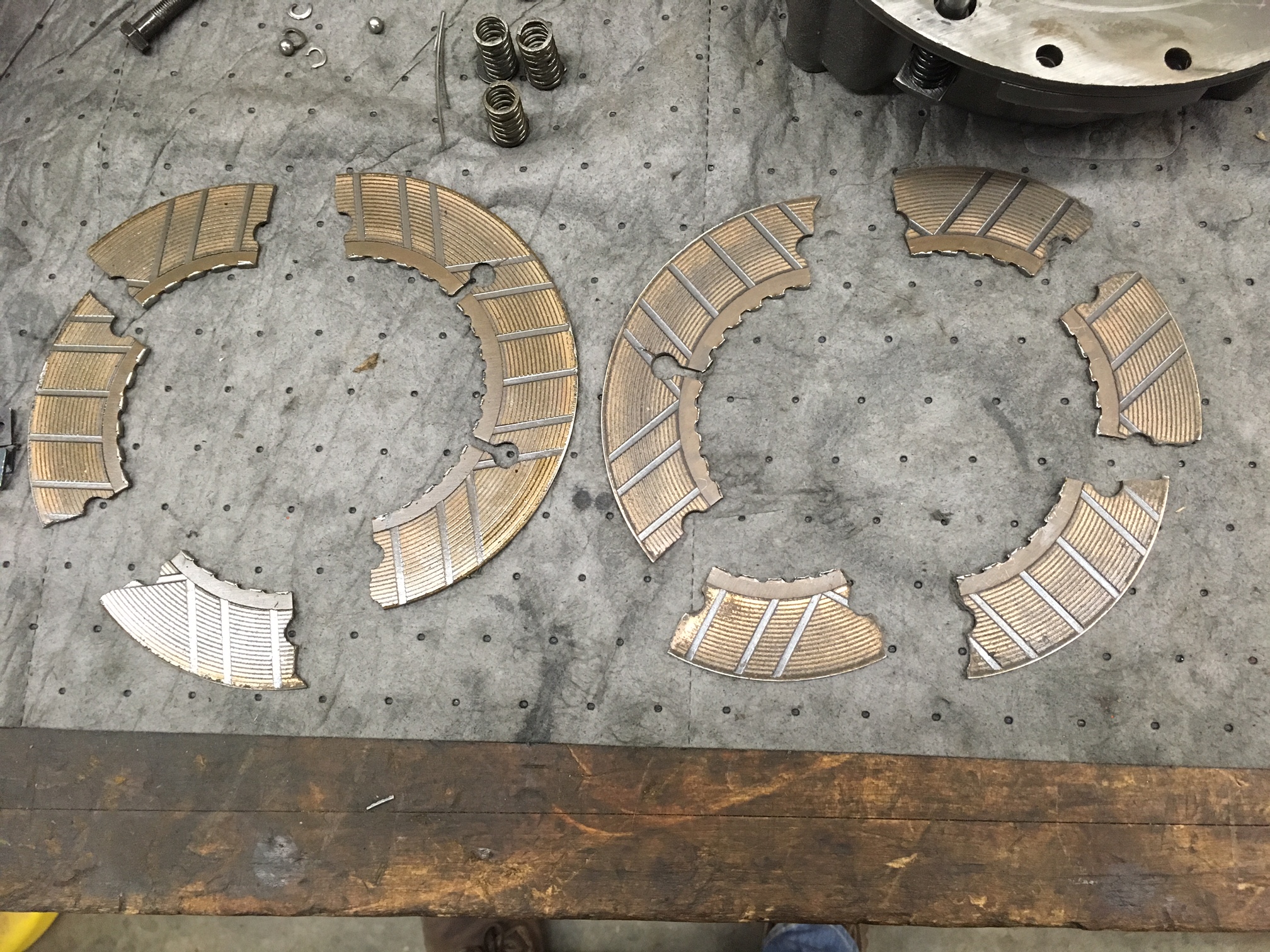

Well, I managed to get er tore apart, and discovered the problem as soon as i split the torque tube from the tranny and saw burnt clutch material splattered all around the inside of the housing. Needless to say I pulled the clutch assembly apart and found two broken discs, as well as a couple burnt separators. When is comes to replacing the discs, keeping cost in mind, is it recommended to replace all of the discs and separators or can I just replace the discs and plates on the high side?

Post Options Post Options   Thanks (0) Thanks(0)   Quote DrAllis Quote  Post ReplyReply Direct Link To This Post Posted: 15 Nov 2016 at 10:55am
If you never want to work on it again, replace ALL discs with new 70261212 discs from a model 7000 tractor. You'll see the difference in the design change, so they'll never break like the old ones did.

Post Options Post Options   Thanks (0) Thanks(0)   Quote DrAllis Quote  Post ReplyReply Direct Link To This Post Posted: 15 Nov 2016 at 11:12am
The 3 sealing rings on the nose of the clutch. The housing they slip into if it has ANY grooves in it from the sealing rings. The oil seal and gasket. (press seal flush with O.D. so as to not block the drain hole) Replace all sealing rings on both clutch pistons and two small Orings between the housing halves. Any separator plates that are warped, or just change them all and know they are new. Six little snap clips on the return spring plungers. Do NOT replace the large bronze bushing inside the front clutch housing, regardless of how bad it looks. I always replace the PTO shift lever seal and the lower PTO shaft seals. I just did a 180 clutch and $1,100 in parts. Yours will be a little more, probably $1500.
