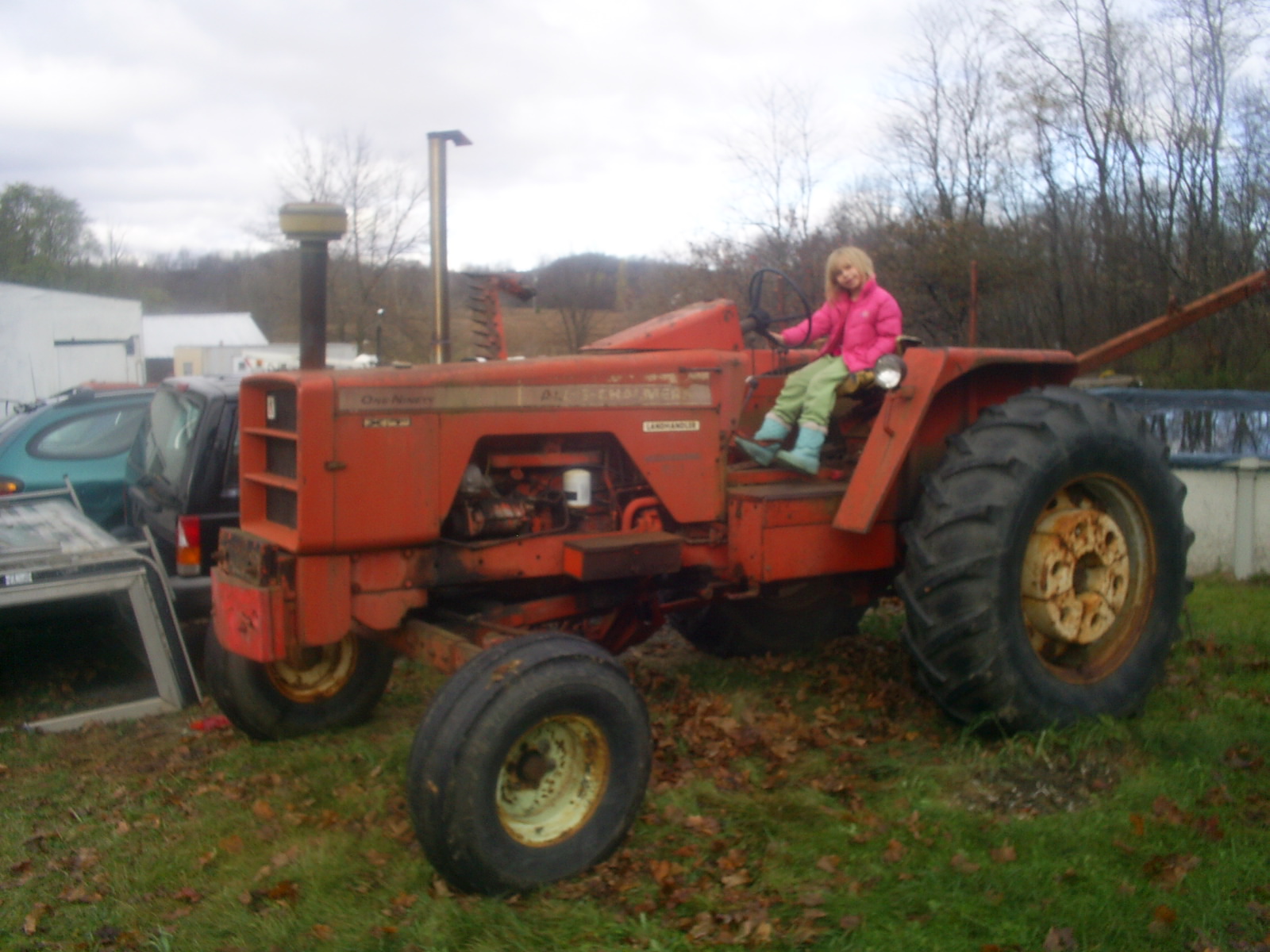

Here is a link to our Series III, there should be 4 pictures

Here's a pic of my Series III with 38" radials.....
