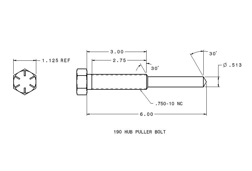

I have to take a rear wheel off my 190. What is the best way to do it, thworst seems to be that big bolted bushing ?

where do i get the pusher bolts ?

If you don't have them I've heard of some guys having them made at a machine shop. I don't remember the dimensions but I'm sure someone on here will know.

just talked to my dealer, $80.00   each, it didn't happen, they don't rent or loan anymore.
It just couldn't happen they would be the same as theones that green color used ??
Ido have a good machinest, any body have the dimensions??  thanks

Never used them, but I heard they are made of VERY hard steel.  Might be hard for a machinist to make.

They have to be hard. I had a machinist buddy make them out of standard dowl rod. Didn't last to long before they bent all to he!!

I made a 3 puller bolts per the image.
I actually used a grade 5 although a grade 8 would be better.
I tightened the bolts with an impact, an hammered on their heads in an alternating manner.
