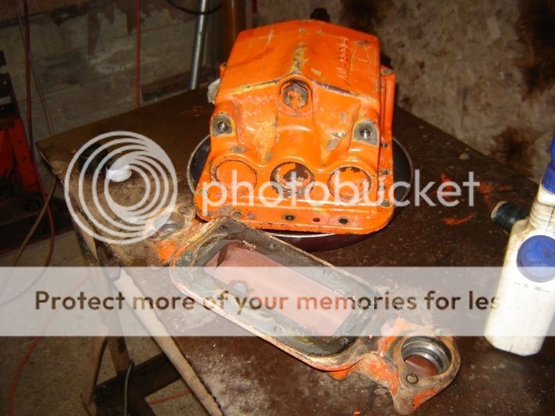

The plug under the seat drains the transmission ONLY.  The hydraulic oil is in the torque tube.  There are a couple of plugs to remove to get all the oil out.  One is behind the brake rod that goes across the tractor. The other is on the left side on an angle.
Here is a picture of the sump (the small thing) when it is removed from the tractor.  The screen sits on top of it.
