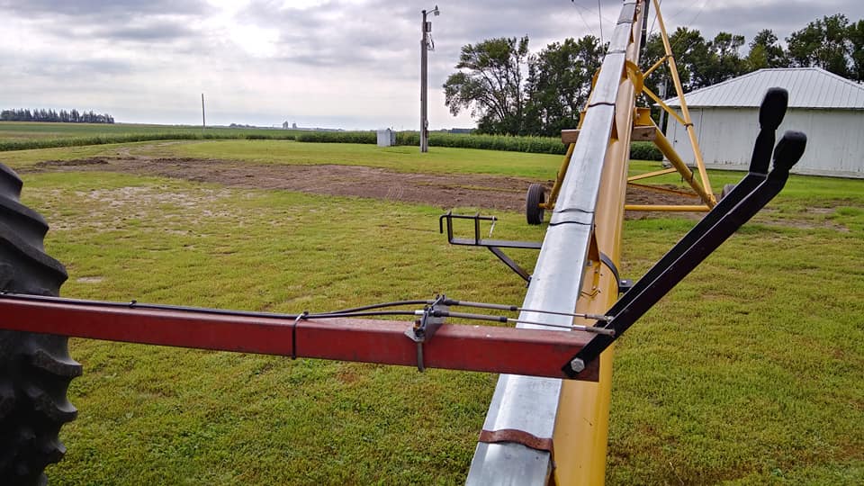

I wish I knew how to post pictures. Don't even try to explain. I am just not computer compatible. That is my wife's trickery.
 Anyway, my 200 has the PTO lever on the right side and the PTO starts like a 7000 or 8000. I run the 540 auger on the small 1000 side of the PTO. The tractor runs at 1300 rpm. I put an arm out behind with 8000 throttle cables and levers on it. The other end of the cables go to the PTO and throttle levers. I can start and stop the auger and throttle up and down from out behind. It runs a 10x71 Allaway.

BIG THANK YOU to my loving wife. She's the best.

Did the cables come off of something or did you have them made?

Late 8000 throttle cable. A long out side 7000 series hydraulic lever was added to to the 200 PTO lever. When the cables are not hooked up, it feels right when you put it in your hand.
