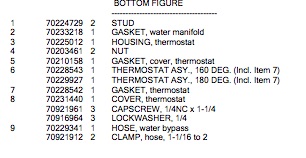

Been calling around can't find one for gas they all say they have number for diesel. Anyone know part number or one that interchanges ?

Below is the list from the AGCO parts book:
http://www.agcopartsbooks.com/PartsBooksN/Viewer/book.aspx?book=agco/79001560
