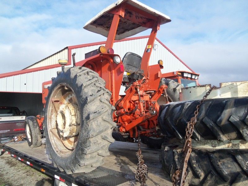

I have to start off by saying that this is my father-in-laws tractor and I know very little about it. A while back, he was brush hogging and lifted the brush hog all the way up. When he tried to lower it, nothing he could do would make it lower. We have since removed the brush hog with a backhoe. If you hit the other hydraulic levers, the pump binds up like normal (no front end loader or other equipment to test if they're working properly). today, we disconnected the hydraulic lines to the two cylinders and set the bucket of the backhoe on the lift arms to try and make them go down. Wouldn't move. What could be wrong? Is there some type of cylinder lock that I'm missing? Please help and thanks in advance.

Update. Finally caught a break in the rain today. I removed the pin from the right hand cylinder and the lift arms went down. I didn't have time to remove the cylinder completely. I stopped here for the day. Would you suggest trying to rotate the cylinder to free it up? What would cause one to lock up like this?
