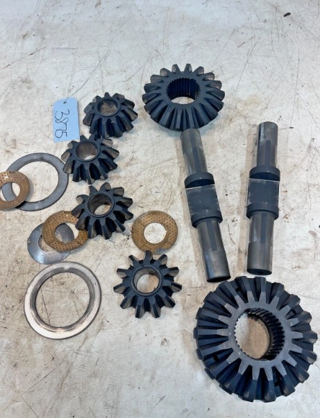

Thanks again all. One last question for the Doc if I may: Thinking about it overnight, I think I will pull it in the other shed and work on it some time in the fall when things are less busy. Wondering about getting a new set of pinions & shafts if I see some come available, knowing they're probably NLA from Agco.
I see this set, supposedly from a 7060 available on Ebay for what seems like a decent price. But the shafts have me confused. I always thought the 7045 and 7060 had the same diff, and never head of any changes or serial number break in them. But the Ebay picture looks like the two shafts have flats in the centre that nest into each other (first pic). Whereas the parts books for both the 7045 and 7060 show the 3-piece shaft setup, with the two shorter stub-shafts nesting in grooves on the one longer through-shaft (second picture).
Was this a change during production? If so, will this (Ebay) style work in the older style diff? I kind of like the nested flat design better. But seeing how it goes together, I can't picture how you'd assemble them in the diff carrier - unless the housing/carrier separates right through the bores where the shafts go (which I don't think it does from what I can tell).

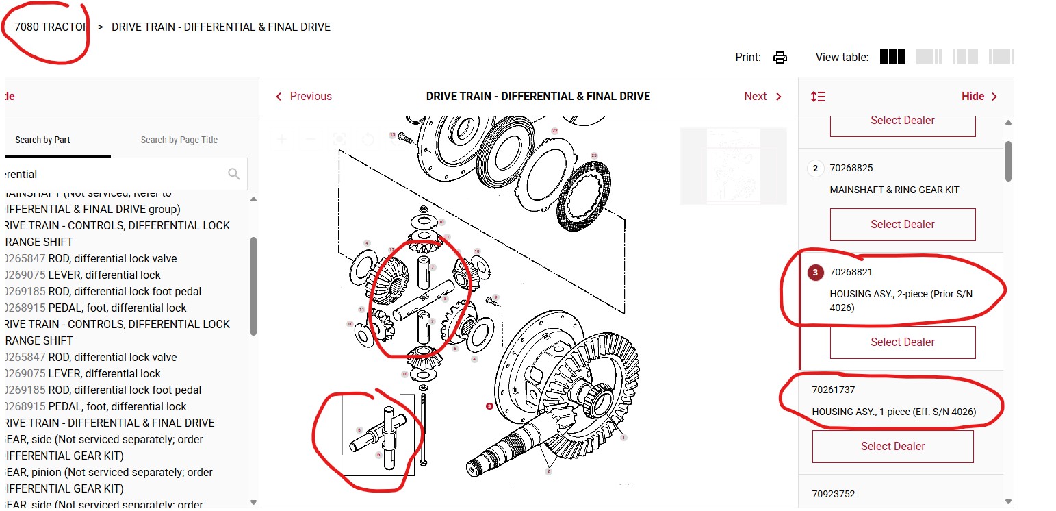

Aha, may have answered my own question. The parts books for the 7045 and 7060 both show only the one (three-piece) shaft style and one style of carrier/housing. But the books for the 7080 show that the earlier serial numbers had a two-piece housing (presumably split right along the shaft bores) and the two-piece style of diff shaft.
Points: 23553
Post Options Post Options   Thanks (0) Thanks(0)   Quote DrAllis Quote  Post ReplyReply Direct Link To This Post Posted: 19 Jul 2026 at 7:59am
The design with a long shaft and two short shafts became effective (approx) with the black chassis series. It cost less $$$$$ to build. The gears might be the same p/n's but the shafts do not interchange between the old housing and the newer housing. There shouldn't be a problem finding used in a salvage yard, as very low oil levels are the cause of failure.

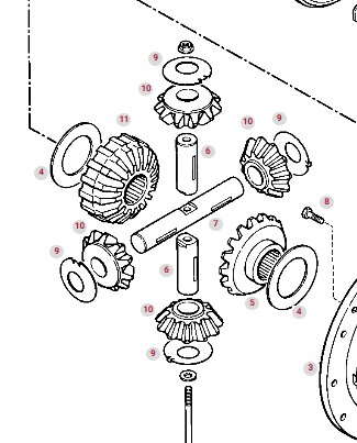

The 7060 was a black chassis and had the newer designed differential with the 8 inch long 3/8" bolt holding in the two stub shafts. When that bolt breaks you get to buy a ring and pinion too.
With the 7045's all being black chassis, I know I have that three-piece shaft. As soon as I saw what it looked like in the parts book I disliked it. I'd much rather have the nested shafts and the two-piece carrier that the maroon-bellies had.
When that bolt breaks, what specifically causes the ring and pinion to fail? Jamming up somehow and shearing? Or crapulence getting caught in the teeth?
It'll be interesting to see what I find. I bought a set of pinions and spiders because I was able to get a good deal on an online set. There are only two ag wrecking yards within several hours of me that have any old Allis's. The nearest one only has one 7000 series - a 7030. Which will have the two-pinion rear end, and which they say has been sitting in their yard with the lift cover off for years, so who knows what that means. The next nearest yard (3 hours away) has a 7060, but they don't allow you to pull your own parts, and say for the cost to have them pull the diff it would be the same price to buy the whole rear end, at $3000. Which I think is rather high for a rear end of unknown condition (tires not included), and it'd be more than I paid for the tractor. So when I saw a set of pinions and spiders for a couple hundred bucks online I thought I'd grab them before they're gone. They were of the earlier style with the nested shafts, but according to the parts books the gears are the same. I'll likely have to make my own shafts (assuming nothing else is wrecked - which is a pretty big assumption). But we have some pretty good CNC tooling and lots of alloys to work with at work, and we send stuff for various heat treating processes all the time. If I can, I'll send an old shaft and gear to them because they do hardening analysis for us (we can do simple hardness testing at work, but the place we send parts for hardening does much fancier analysis). The old chap who runs the place is great to talk to, and often does analysis for us free as we're a common customer.
What I wonder about (and half suspect) is if Allis had similar hardness pinions and shafts. Which was a common mistake in the 60's and 70's - certainly not limited to Allis. When dealing with hardened metals (especially higher carbon alloys) it's important to have metals that are in dynamic contact with each other to be of dissimilar hardness. I always said at least 5 points on the Rockwell C scale different, but the Googles is telling me 10. Whatever the minimum difference is, it's for this reason: If you have metals of dissimilar hardness rubbing together, if they're lacking lubrication (if, for instance, someone ran the rear end 10 gallons low on oil), at least with dissimilar hardnesses one is just going to wear out and they'll just wear and get sloppy. But if they' re similar in alloy & hardness, instead of wearing out they'll gall/weld themselves together. Which sounds like what happened with the spiders on their shafts.
