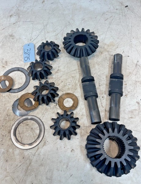

Thanks again all. One last question for the Doc if I may: Thinking about it overnight, I think I will pull it in the other shed and work on it some time in the fall when things are less busy. Wondering about getting a new set of pinions & shafts if I see some come available, knowing they're probably NLA from Agco.
I see this set, supposedly from a 7060 available on Ebay for what seems like a decent price. But the shafts have me confused. I always thought the 7045 and 7060 had the same diff, and never head of any changes or serial number break in them. But the Ebay picture looks like the two shafts have flats in the centre that nest into each other (first pic). Whereas the parts books for both the 7045 and 7060 show the 3-piece shaft setup, with the two shorter stub-shafts nesting in grooves on the one longer through-shaft (second picture).
Was this a change during production? If so, will this (Ebay) style work in the older style diff? I kind of like the nested flat design better. But seeing how it goes together, I can't picture how you'd assemble them in the diff carrier - unless the housing/carrier separates right through the bores where the shafts go (which I don't think it does from what I can tell).

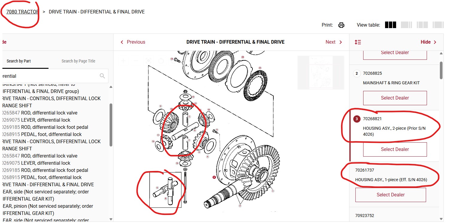

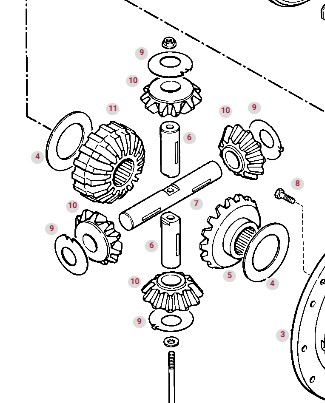

Posted By: DanielW
Date Posted: 19 Jul 2026 at 7:59am
Aha, may have answered my own question. The parts books for the 7045 and 7060 both show only the one (three-piece) shaft style and one style of carrier/housing. But the books for the 7080 show that the earlier serial numbers had a two-piece housing (presumably split right along the shaft bores) and the two-piece style of diff shaft.
Posted By: DrAllis
The design with a long shaft and two short shafts became effective (approx) with the black chassis series. It cost less $$$$$ to build. The gears might be the same p/n's but the shafts do not interchange between the old housing and the newer housing. There shouldn't be a problem finding used in a salvage yard, as very low oil levels are the cause of failure.
