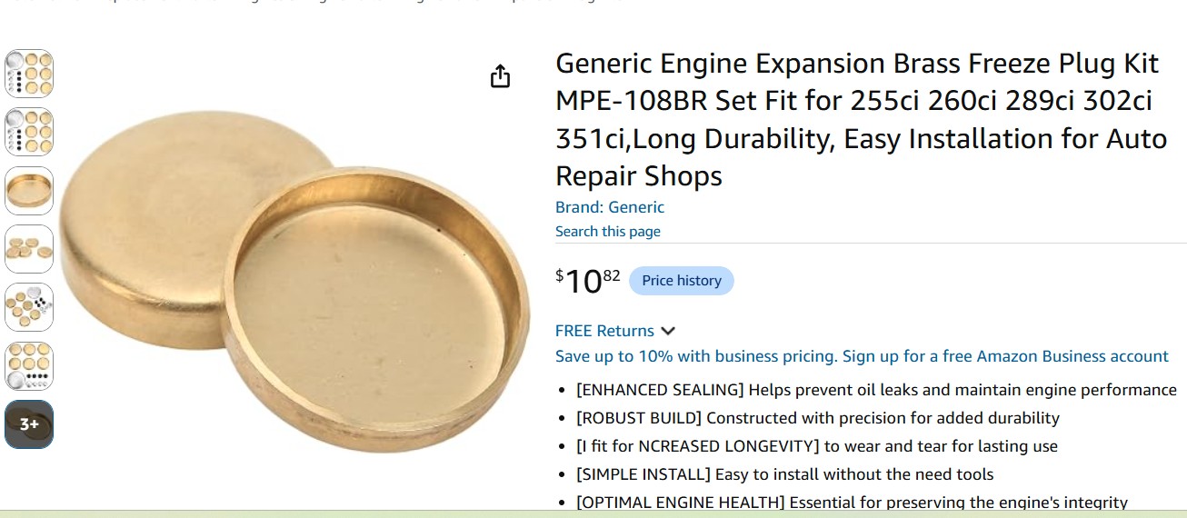

i dont think there are any threads in that hole ??  Seems like it is similar to a FREEZE PLUG that you pound in a hole to seal it up ???
You should be able to use a GENERIC plug if you measure the ID of the hole..does it look something like this ??? you would need to check the RIGHT DIAMETER...

The plug keeps it from leaking hydraulic oil. There are no threads in there and I am starting to think the answer of finding a generic plug like a freeze plug and driving it in seems to be the fix. I think Napa has something I can use.

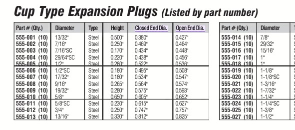

Post Options Post Options   Thanks (0) Thanks(0)   Quote steve(ill) Quote  Post ReplyReply Direct Link To This Post Posted: 15 Jul 2026 at 1:30pm
DORMAN part numbers available at NAPA.... just match the HOLE SIZE
