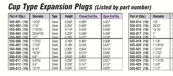

i dont think there are any threads in that hole ??  Seems like it is similar to a FREEZE PLUG that you pound in a hole to seal it up ???
You should be able to use a GENERIC plug if you measure the ID of the hole..does it look something like this ??? you would need to check the RIGHT DIAMETER...
Posted By: muck7898
Date Posted: 15 Jul 2026 at 1:24pm
The plug keeps it from leaking hydraulic oil. There are no threads in there and I am starting to think the answer of finding a generic plug like a freeze plug and driving it in seems to be the fix. I think Napa has something I can use.
Posted By: steve(ill)
Date Posted: 15 Jul 2026 at 1:30pm
DORMAN part numbers available at NAPA.... just match the HOLE SIZE
