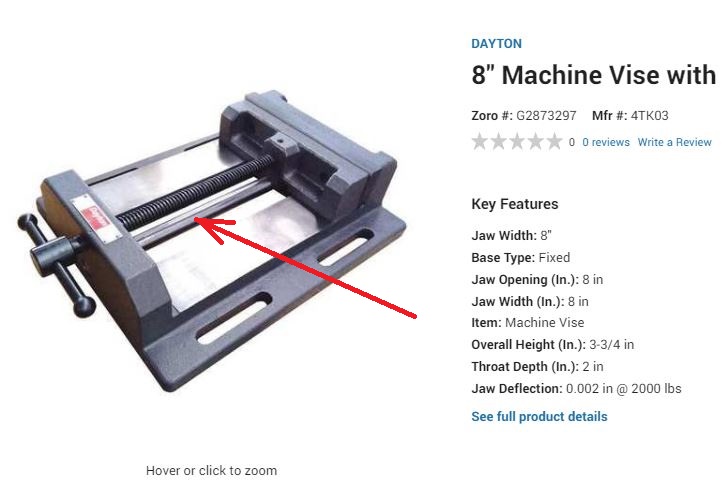

The vise i have now is similar to this picture, but mine is 6 inch... look at the alignment rod below the threaded shaft... The sliding jaw rides on that.  I think that is important .

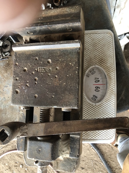

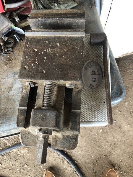

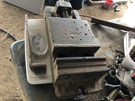

   Check out the scale on the weight of this brute,,,,,,!! Don't fret yourself none,,the vise I got with that mill arrangement 3 months ago has an almost new Kurt  6" X 16" on a swivel base on a 6" X 24" new Vevor table,,,I had to use a come-a-long to remove it from table it was soo dang heavy!! Don' got to worry bout any thieves running off with it,,,LOL....
Hopefully someone here will be able to ID this brute for us,,,ClapClap

poor thing looks like it was on the moon for a few years ! Did it happen to 'walk out' of Area51 by any chance ??

  Well, Thad,,don't fret none, This one IS Old, antique and maybe even priceless,,,,them two are just jealous,,,,,⬇⬇

HEA... im on your side JOe... Looks ANTIQUE and PRICELESS to me !!  Wink

That is a Brown & Sharpe #3 FLANGED milling vise...
The handle was made from a broken-off JH Williams vise.
It's a quality vise... notice- two guide slots, and an oil lubricator point.
If you disassemble and clean the B&S, stone off any protruding nicks from the travelling slots, clean up and oil or replace the leadscrew bushings, refit the pieces to proper clearance, and replace the jaws, you'll have AT LEAST the equivalent precision and grip of anything new.  If you make it extra-snug, you'll beat it.
LIFT up is a result of the movable jaw fitment being too loose.  Insufficient grip is either from same, or having loose or worn out jaws.
The biggest failure of any milling vise, is caused not by the vise, but by the operation.  Always cut into the NON-MOVABLE jaw... not across the work laterally, not into the movable... that's where the vise's best strength is.
Second failure, is blaming the vise, when there's unsecured non-used axis... if you're making cuts, any unused axis will react, and even a slight movement will cause the cutter to 'hog in' or deflect, even break... or if it doesn't, it'll leave you with a wierd cut.
I've got several Kurts, several B&S, some smaller British vise (it IS nice) and a Kearney&Trecker that is about 10" x 10", and weighs around 130lbs.  Generally speaking, a strong vise can be measured by how well it holds things to the ground... ;-)

Looks like Joe has a dang good old vice to me.

  Hey Dave Kamp, many Thanks for ID'ing this brute for us,,,,I felt it was a quality piece as it is well built and has lasted an awful long time and has had very little use. I did not show very good pics as both jaws are almost cherry (whoops, can we say that here?) The only'ist thing I can throw sticks at is the operator must of been far sighted as they did drill thru the work a few times and into the btm of frame but not near enough to affect it's effectiveness or longivity,, If I can bail out of bed this pm I;m go to post office and see bout a flat rate box for this brute,,,,,

joe ... since the holes are a VISUAL problem and not a STRENGTH problem, you can clean out the holes with a burr and fill them with JB weld and sand smooth.. I have done that and it helps the LOOKS 100%... and the JB is about the same color as sandblasted steel.
