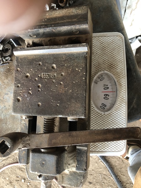

 Hey Thad,,here is the vise I mentioned for that behemoth you gots,,,lol. It is a "no Name" as the only'ist thing I find is "No 3" cast on top of vise. It is 6" X 20" with the jaws at 4" X 2" high and in great conditions with travel of 4", The ways are in great conditions and tool os very "TIGHT"  The drive screw is tight as well. The only'ist thing I see is the PO couldn't tell when he drilled thru the work and drilled into the base,,,but don't hurt a thing.
 Having trouble posting pics as tried several times but  don't see the green tree icon ,,,,?  WTH,,,??

   Check out the scale on the weight of this brute,,,,,,!! Don't fret yourself none,,the vise I got with that mill arrangement 3 months ago has an almost new Kurt  6" X 16" on a swivel base on a 6" X 24" new Vevor table,,,I had to use a come-a-long to remove it from table it was soo dang heavy!! Don' got to worry bout any thieves running off with it,,,LOL....
Hopefully someone here will be able to ID this brute for us,,,ClapClap

poor thing looks like it was on the moon for a few years ! Did it happen to 'walk out' of Area51 by any chance ??

  Well, Thad,,don't fret none, This one IS Old, antique and maybe even priceless,,,,them two are just jealous,,,,,⬇⬇

Looks like this... but still no name other than " #3 "......

That is a Brown & Sharpe #3 FLANGED milling vise...
The handle was made from a broken-off JH Williams vise.
It's a quality vise... notice- two guide slots, and an oil lubricator point.
If you disassemble and clean the B&S, stone off any protruding nicks from the travelling slots, clean up and oil or replace the leadscrew bushings, refit the pieces to proper clearance, and replace the jaws, you'll have AT LEAST the equivalent precision and grip of anything new.  If you make it extra-snug, you'll beat it.
LIFT up is a result of the movable jaw fitment being too loose.  Insufficient grip is either from same, or having loose or worn out jaws.
The biggest failure of any milling vise, is caused not by the vise, but by the operation.  Always cut into the NON-MOVABLE jaw... not across the work laterally, not into the movable... that's where the vise's best strength is.
Second failure, is blaming the vise, when there's unsecured non-used axis... if you're making cuts, any unused axis will react, and even a slight movement will cause the cutter to 'hog in' or deflect, even break... or if it doesn't, it'll leave you with a wierd cut.
I've got several Kurts, several B&S, some smaller British vise (it IS nice) and a Kearney&Trecker that is about 10" x 10", and weighs around 130lbs.  Generally speaking, a strong vise can be measured by how well it holds things to the ground... ;-)

  Hey Dave Kamp, many Thanks for ID'ing this brute for us,,,,I felt it was a quality piece as it is well built and has lasted an awful long time and has had very little use. I did not show very good pics as both jaws are almost cherry (whoops, can we say that here?) The only'ist thing I can throw sticks at is the operator must of been far sighted as they did drill thru the work a few times and into the btm of frame but not near enough to affect it's effectiveness or longivity,, If I can bail out of bed this pm I;m go to post office and see bout a flat rate box for this brute,,,,,

joe ... since the holes are a VISUAL problem and not a STRENGTH problem, you can clean out the holes with a burr and fill them with JB weld and sand smooth.. I have done that and it helps the LOOKS 100%... and the JB is about the same color as sandblasted steel.
I've done that... and I've had machines with holes drilled elsewhere that I didn't want, and I fixed 'em in other ways... like... find an appropriate sized tap, tap it for threads, red-loctite thread in a screw, saw it off 1/8" proud, then give it a quick 'kiss' with 4" grinder and flapdisk... then paint! ;-)
Battle scars happen, particularly with vises.  It's like...  us... as we work, we wind up with cuts and bruises, scrapes and scars... missing toes, chipped teeth...  but unlike machines, we can't be carefully worked back into pristine condition, we're just condemned to be ugly curmudgeons overweight with experience, and shops full'a tools we never use, right? LOL

most of your "HOLES" see to be on the top of the movable jaw  !!  You can fill them, then PAINT and no one will know... Normally the holes are between the jaws in the frame rails... that area is not painted, but the JB fills in well.

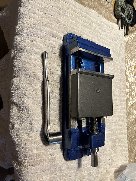

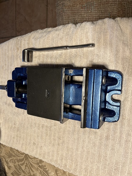

  Well,, you guys take a gander at this tool and tell me if ole Thad might like it now,,,,,? Just goes to say,,,a little amount of elbow grease will do wonders with good quality tools that have suffered some abuse,,,,.
 That JB Weld will work wonders and will also hide a multitude of sin.,,,,WinkWink
 Only'isr thing is now to figure how to get this heavy sob into Thad's hands,,,,just weighs 53 pounds,,!! Don't believe I'm gonna send USPS,,,,LOL
CHIT,,can't get it tp load the pics,,,chit,,!!

 OK, Gents I been doing an fbi on all the
how to's on the web and since I have a new IPhone 14 Plus,,,it IS different than my old IPhone 8 and takes a somewhat different method to transfer pics from IPhone to PC,,BUT, BUT,,,"NOT" to transfer to the ICloud as I do not like the idea of having my pics on that cloud because it establishes a "line" from it to your PC, ,,,. SO, I wanted my pics to stay on my hard drive where I can then transfer to my External hard drive at my leisureClap

Appears an old Milton

WOW......... thats PURDY !!  Clap

Wow that looks too good to use.
Purdy.

 Well, I Thank yee, Guys,,,!! That JB Weld is super great stuff ain't it?,,Clap Don't have an idee how old this tool  is but the ways are perfect  and just as tight as a youn,,,,er,,,never mind!!Wink  You can spin the jaw handle with one finger just as slick as,,,,well,,there I go again,,,,LOL It does have a tiny lube hole for the jaw screw and wonder if there was ever a oil chingas there? I may try to machine a press fit plastic plug or maybe brass to keep trash out of that spot,,,?
 The weight of this thing is really impressing me cause you DO NOT want to have to move this behemoth more than once a year,,, 56 Lbs of heavy iron!! Now,, getting it to ole Thad is next challenge,,,,,Clap

Nice cleanup, Joe!
In a typical shop, a guy would put a drop or two of way oil (like Vactra) in that lube point, and a little on it's ways and leadscrew... mebbie every time or two that they oiled any nearby machine's manual lube points.  They'd also put a little on any nearby chucks and tooling... then move on to the next work bay.  One of my (now long passed) buddies started at IH as the 'oil cart' guy- he pulled a wagon with a barrel and hand pump, refilling oil cans and topping the Bijur automatics' reservoirs... once a day, from one end of the wing, to the other, and back.  Guys on the line would stop the machine between parts just long enough for him to get in there...

 Well,,,seeing as I gots Dave Kamp's stamp of approval along with everybody else's,,,I'm OKAY,,,,!!! Hey Dave K,,,  Now that I'm done,,,do I get any of that money back,,,,😊😊

Well, I think three orders of JB Weld might still be more expensive than a dozen eggs... LOL
