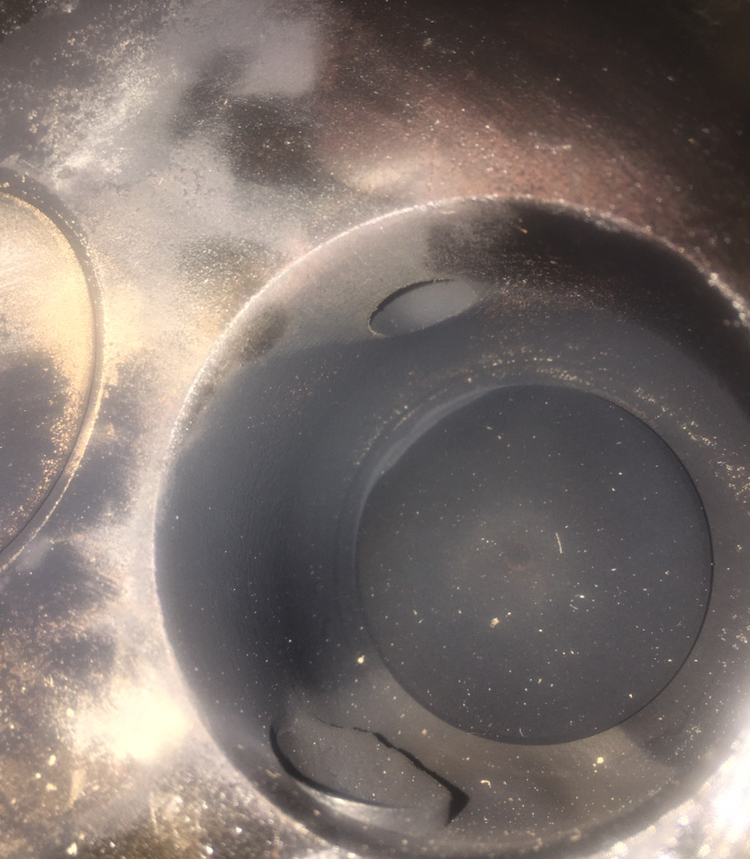

Now I think it might have a bad head gasket. It is foamy in the radiator. Does anyone know where to get a Copper head gasket?
55allis View Drop Down
Joined: 30 Jun 2020
Location: Griswold Iowa
Points: 1418
Post Options Post Options   Thanks (0) Thanks(0)   Quote 55allis Quote  Post ReplyReply Direct Link To This Post Posted: 03 Dec 2020 at 9:15pm
Got the head off of it and the head gasket looks fine but the head has a bunch of cracks around the intake valve.
If you look closely at the picture you can see the cracks.

MACK View Drop Down
Joined: 17 Nov 2009
Points: 7664
Post Options Post Options   Thanks (0) Thanks(0)   Quote MACK Quote  Post ReplyReply Direct Link To This Post Posted: 04 Dec 2020 at 8:16am
Why do you want a copper head gasket? If the sleeves are low, a copper gasket won't help.           MACK

Ok now with a update.
Found a guy who makes copper head gaskets so I’m having him make me one. Now the problem is finding head bolts that are not too expensive, I call my Agco dealer and they said it was $1600 for a kit so a little too much $$$$ for me.
