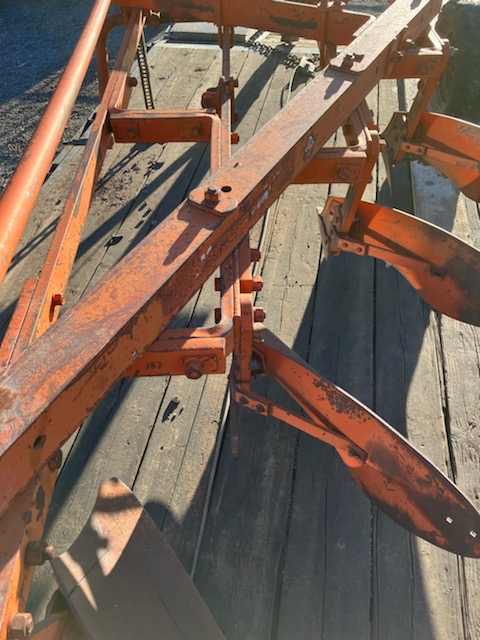

what model plow is this

4 bolts on the shears  three bolts in a straight line  the  the front one is alittle lower  none of the center to center on the bolts is the same
Points: 23550
Post Options Post Options   Thanks (0) Thanks(0)   Quote DrAllis Quote  Post ReplyReply Direct Link To This Post Posted: 14 hours 8 minutes ago at 10:24pm
If the frame width can be assembled 14 or 16 inch width I'd say 70 series. Bolted only to one frame width 60 series.

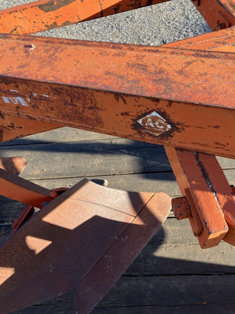

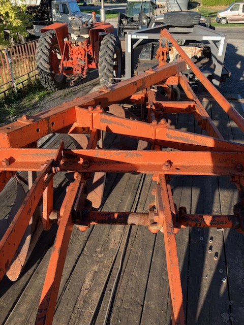

does this help alittle bit dr. allis   need to find shears for this and land slides also
Points: 23550
Post Options Post Options   Thanks (0) Thanks(0)   Quote DrAllis Quote  Post ReplyReply Direct Link To This Post Posted: 1 hour 17 minutes ago at 11:15am
70-series. There is more than one plow "bottom" for the 70-series. And that determines what shares or landsides. I have made my own landsides out of 1/2" or 3/4" flat steel. They won't last as many acres as OEM, but my plow days don't happen that often and new landsides sure do keep the plow straight when plowing.

Are the shears 3 bolt or 4 bolt, that is something you need when looking for them.
