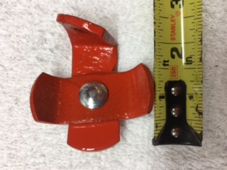

Does anyone know what this part is?  I remember taking it off the left side (as sitting on tractor) floor board.  Can't remember how to put it back on or what it actually does. I might even have it put together wrong in this picture.  Any help would be appreciated.

I think its a bracket that holds the hydrolic lines. What tractor was it on.

Sorry, I should have mentioned, it is a D14.

Yep.  That is the securing bracket for the return hydraulic line.  You do have it put together wrong.  L shaped piece comes down against line on one side and the U piece butts against it with the line in the middle.  Also should be a rubber piece to prevent vibration wearing the line down.

That's what it is. Usually the rubber is brittle one falling apart and no good, so I just find a piece of rubber round tubing that fit's over the hydraulic pipe and cut it to fit, looks good and works like a charm.
