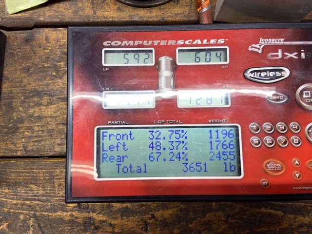

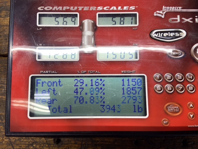

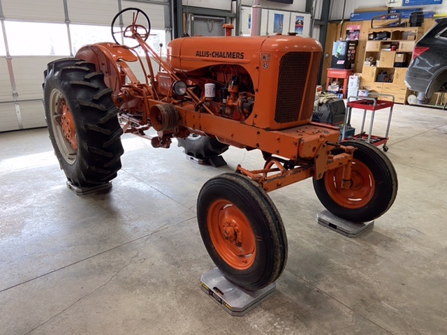

So as you can see I had not enough to do today. So I washed a few vehicles and then scaled the WD45. Lol. So 1954 WD45. All stock except rear tires and rims. I have 13” rims and 14.9 x 28 Firestones. About 1/2 tank of fuel and factory drawbar in place. 3651 lbs is first pic total weight. Next pic just shows the setup. Last pic is with a driver on board but not me! I’m not that heavy(300 lbs as you can see). For a total of 3943 lbs. Time well wasted. Smile  So anyone that was betting against Doc you can send him your money now!!!

My 12 volt battery is probably a few pounds lighter than an old school 6 volt and my toolbox is always empty when I go pulling!! Thank you for the "weigh-in" numbers !!
