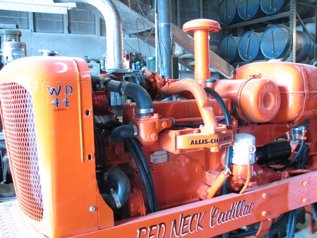

I have received permission from the owner to post some pictures. I have sent them in a PM to JoeO.
The hood, fenders and other parts were removed before he brought it to my shop. The final drives are not painted because they were recently replaced.
He has very nice 4 gauge panel that has been relocated while working on it and is not shown in the pictures.

Resized and loaded!

Wow, that's a cool build!
Someday I want to get a SP-100 All-Crop combine and put a 433 in it. That'll turn it into a "true" Super 100!

I think its awesome!!!! its not all butchered up.. I would love to see that pull...

Yes the owner did a really nice job of finishing the install. I think the front end was from a 180 and the steering setup may of been from the same combine that the engine came from.
