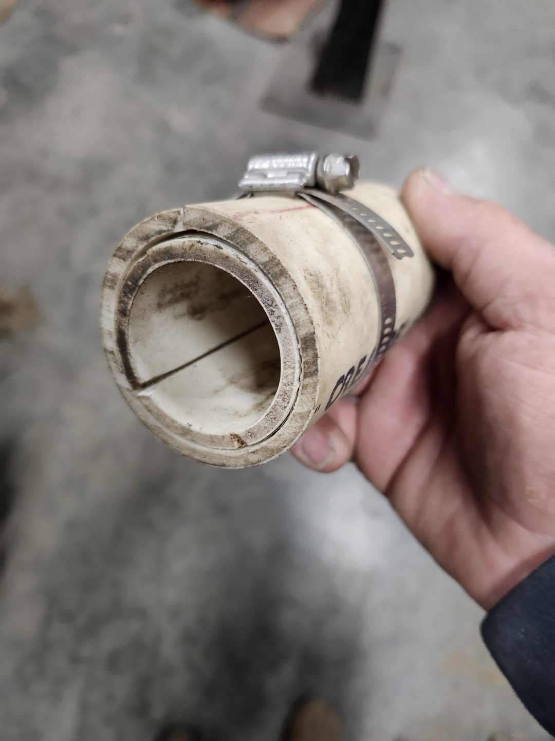

Post Options Post Options   Thanks (0) Thanks(0)   Quote plummerscarin Quote  Post ReplyReply Direct Link To This Post Posted: 17 Nov 2024 at 11:31am
This is what I made to install a cover on a 170 engine

Post Options Post Options   Thanks (0) Thanks(0)   Quote MrSuter Quote  Post ReplyReply Direct Link To This Post Posted: 23 Nov 2024 at 10:02am
Thank you for the ideas. I like the slits in the PVC pipes. I could certainly do that with the tools and supplies I have. I wish I had a lathe to make things like that. Maybe someday...
