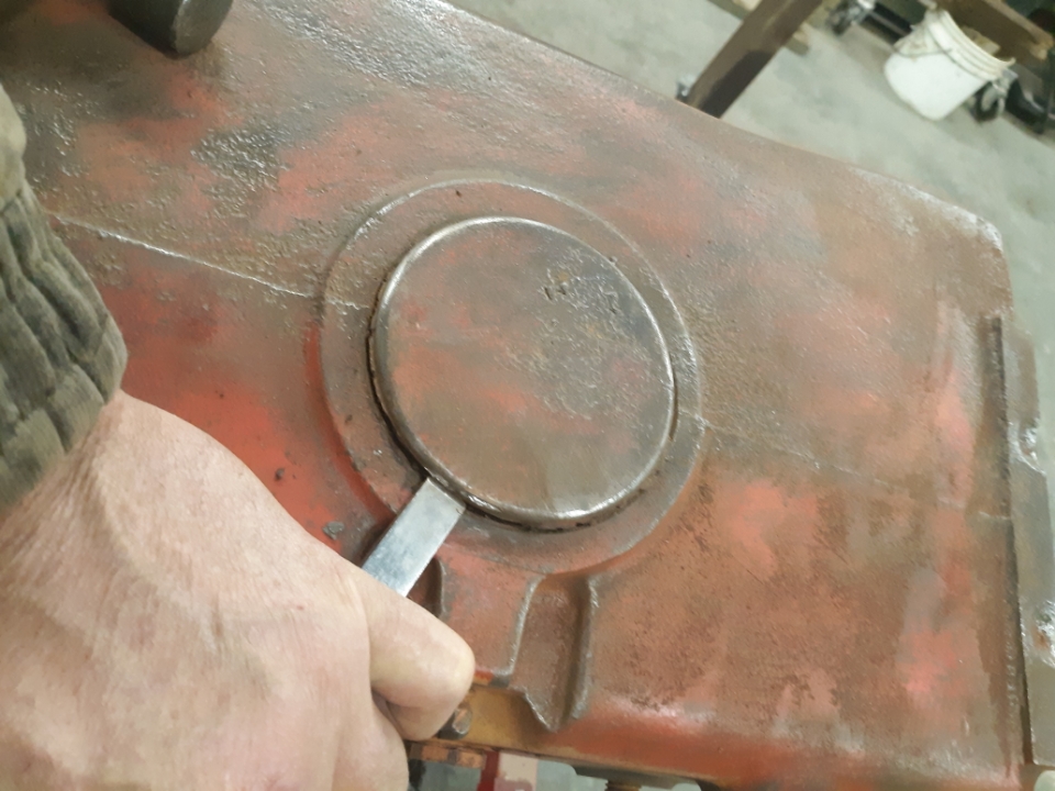

Started working on tearing down this afternoon.  Spent some time working on removing the round cap on top.  I have it lifted up a bit, still more to go.  For removing the entire bolster, the universal joint needs to be disconnected from the steering shaft.  I see mine has a solid round pin keeping things together.  Any ideas how to removed the pin?  It's also under the governor - not the most accessible location!
Next question:  the manual specifies SAE 240 fluid for the bolster, however I do not see any fill plug in the top - just a grease zerk.  Very confusing!  Can someone clarify?

Post Options Post Options   Thanks (0) Thanks(0)   Quote plummerscarin Quote  Post ReplyReply Direct Link To This Post Posted: 27 Dec 2022 at 6:19am
I used a pitman arm puller to drive out the pin. It took a series of small nuts stacked up as the pin pushed through. There are photos in my "Dads WD project" thread. Admittedly, I had the side frame off for better access but the whole tractor was coming apart anyway

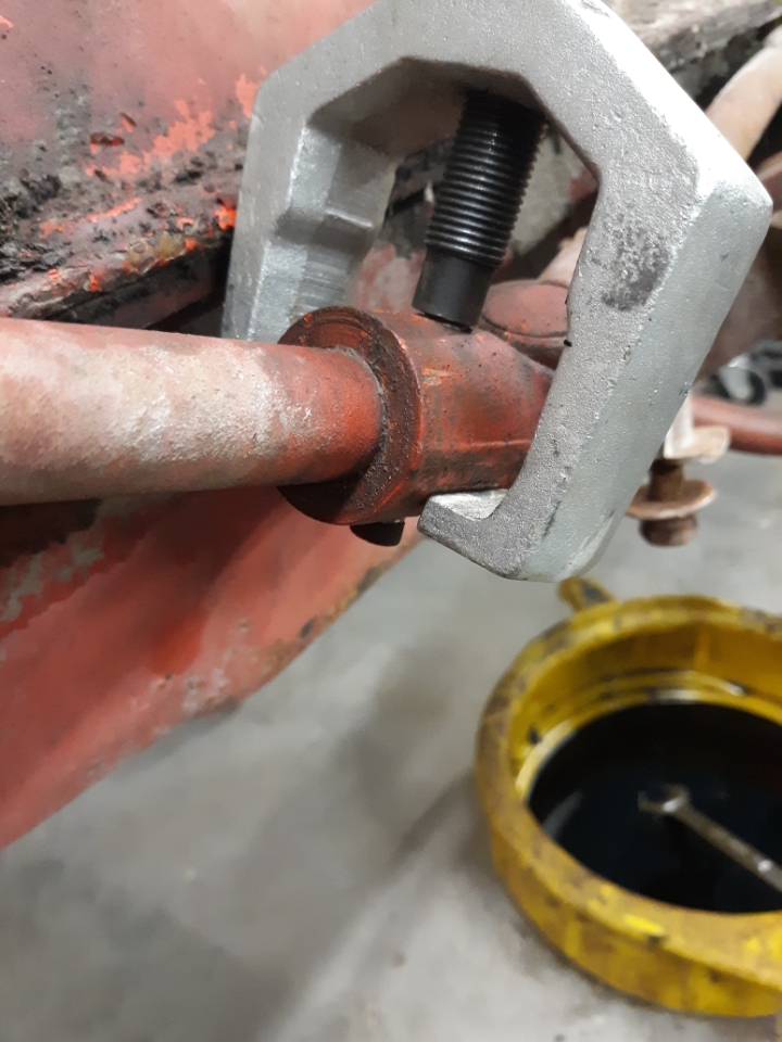

Post Options Post Options   Thanks (0) Thanks(0)   Quote DSeries4 Quote  Post ReplyReply Direct Link To This Post Posted: 13 Jan 2023 at 8:33pm
More questions:
1)  What is the best way to remove the solid pin on the universal joint?  I am reluctant to use heat as I do not want to cook the grease in the U joint.
2)  What is the diameter of the hole in the U joint?  Can a regular roll pin be used when reinstalling the bolster?
3)  What is the best way to grease the universal joint?  I do not see a grease zerk on mine.

Post Options Post Options   Thanks (0) Thanks(0)   Quote Gary Quote  Post ReplyReply Direct Link To This Post Posted: 14 Jan 2023 at 6:17am
Hi Myron
Are you sure it is a 'solid' pin and not a spring pin packed solid with rust ?
I'd try running a small drill through the middle of the pin.
I'd remove the Side Rail to have better access to the Universal.
You'll be removing the front 4 bolts and loosening the rest in order to remove the Bolster anyway.
As a last resort, if it is a solid pin, I'd drill the outer ends of the pin on the Bolster side of the Universal to weaken it, then twist the steering shaft to sheer the remaining pin.
I see replacement Universal Joints have a Grease Zerk.
Gary
https://www.amazon.com/Steering-Chalmers-Interchangeable-70224825-70224825GV/dp/B08C8YNC9Y
Pin 912855   3/8 inch

Post Options Post Options   Thanks (0) Thanks(0)   Quote plummerscarin Quote  Post ReplyReply Direct Link To This Post Posted: 14 Jan 2023 at 7:16am
Mine is also a solid pin. This was my solution. Apply pressure to pin tap the end of the pusher bolt. Rinse repeat. I stacked small nuts over the pin as progress was made
I used a flat chisel to work the cover up out of hole.

Hi Gary, it's definitely a solid pin.  I have all the bolts holding the bolster loosened and I am planning to remove the left side frame rail so I do not have to deal with the belt pulley seal on the right side..
The existing U joint is still very good.  No slop in it, so I prefer to keep using it.  However I would like to grease it when I get everything apart.  I will take a closer look, but I don' t recall seeing a grease zerk...

Post Options Post Options   Thanks (0) Thanks(0)   Quote SteveM C/IL Quote  Post ReplyReply Direct Link To This Post Posted: 14 Jan 2023 at 9:48am
I use a hammer and punch from bottom side on those pins.
