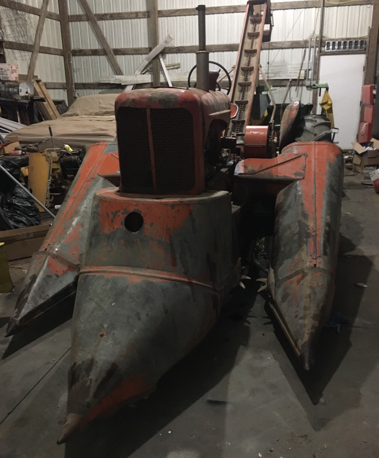

Hey a’ll,
Well I started another project: a WD with a 33 picker.
It has real good spark but won’t fire even with starting fluid so I’m completely lost of what to do.

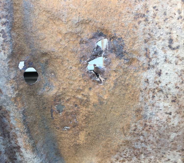

I ordered a set of 13.6-28 tubes and took a rim in to my local welding shop to fix around the valve stem ( it had rust holes).

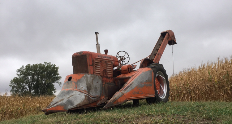

Here’s a picture of it with the shields.
