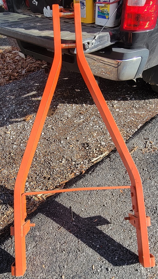

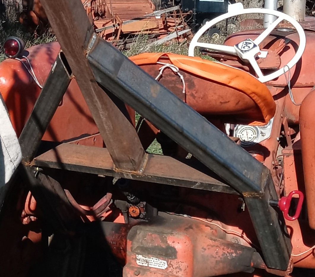

Hello everyone, I am in process of fabricating.
Bit of a purist, please bear with.
Was original Crane arms, bent to their shape?
All photos I have seen appear so….

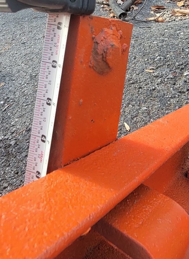

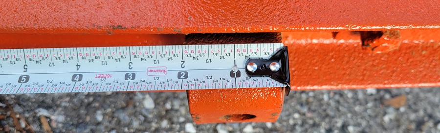

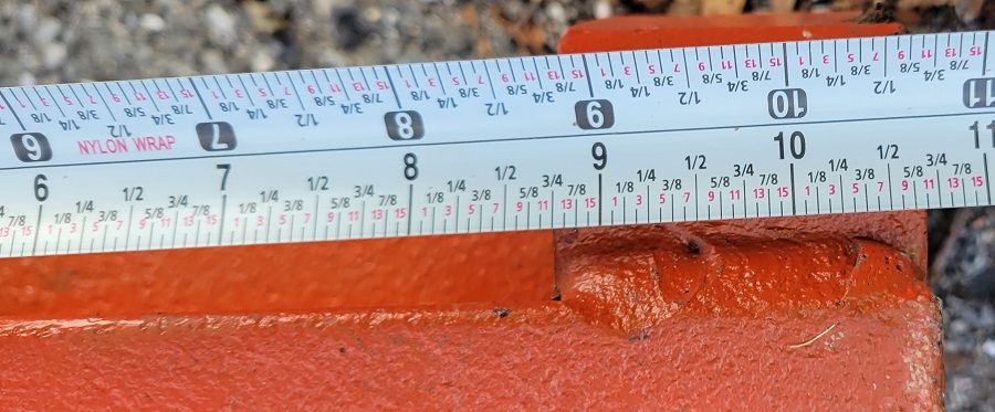

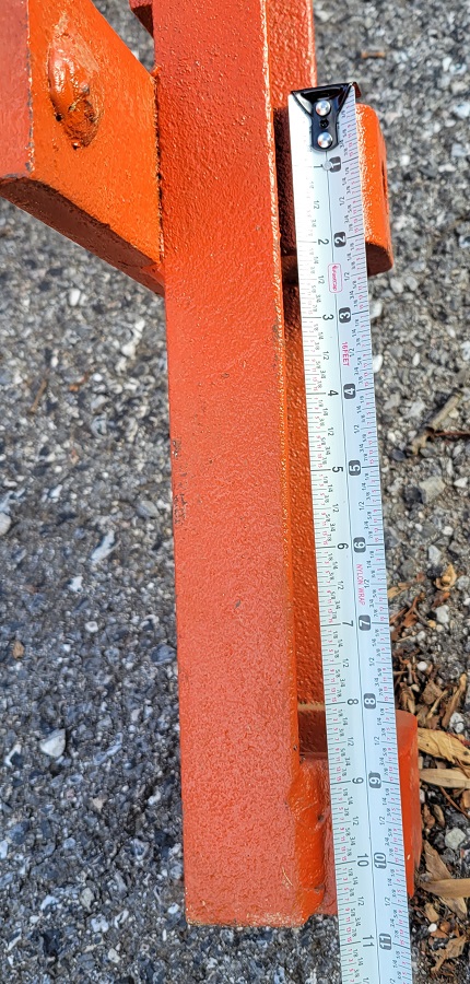

I’m also needing a measurement….

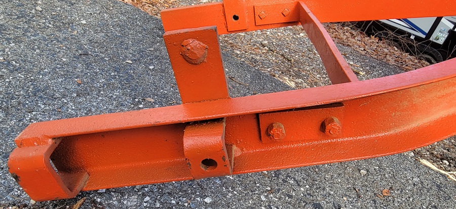

Where the Crane arms slip over the lift arms, what’s the dimensions, of the 2 “C” shaped pieces?
These pieces hold Crane in place.
One has quick hitch pin.
My book shows that they are not a tight/snug fit.
Anyone who has an original, any measurements/ close pictures/with a ruler would be great!
Hope you guys are doing well, thanks again!

I'll post some pics of mine for you tomorrow.

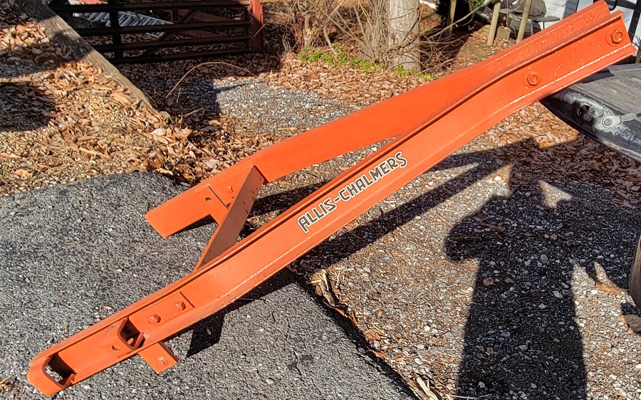

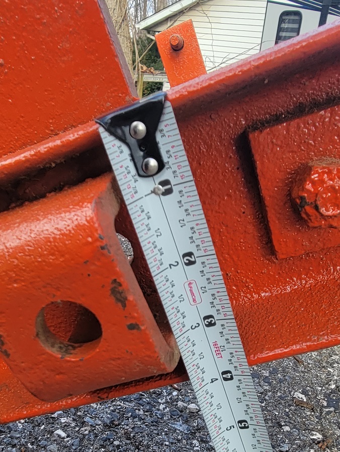

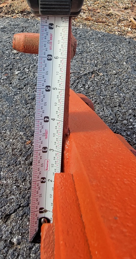

Hope these help. If you need something different, let me know.

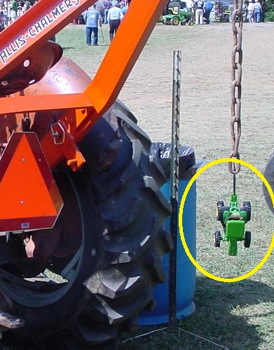

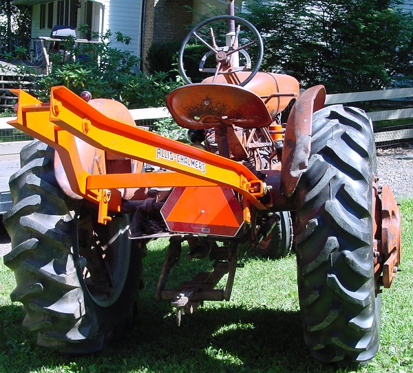

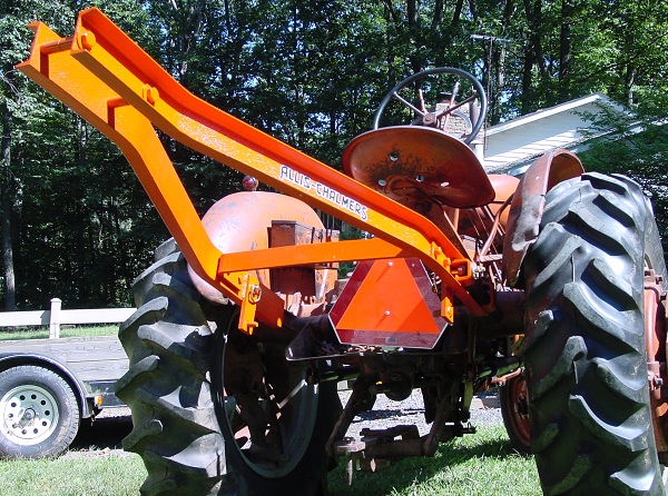

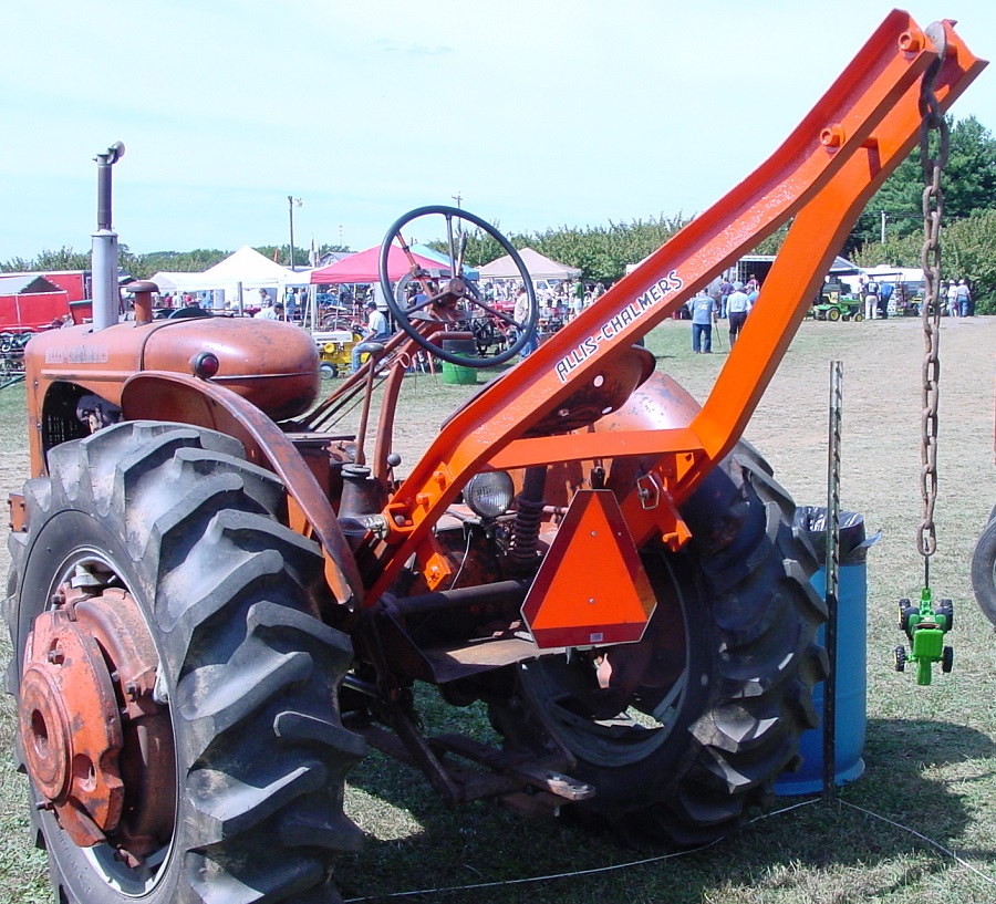

This is how I display it at shows........

You ARE THE MAN!
Much thanks!

how wide is it out at the end between the channels where the chain is hooked hanging the john deere

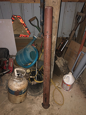

There's pictures of my crane the main tube is 42" and the one that slide in is 41" and there was a hook with a swivel on the end till I tryed to drag with it and broke it off. It was copied after a AC one.
4 inches

Now that I see pictures of an original, mine turned out pretty good!

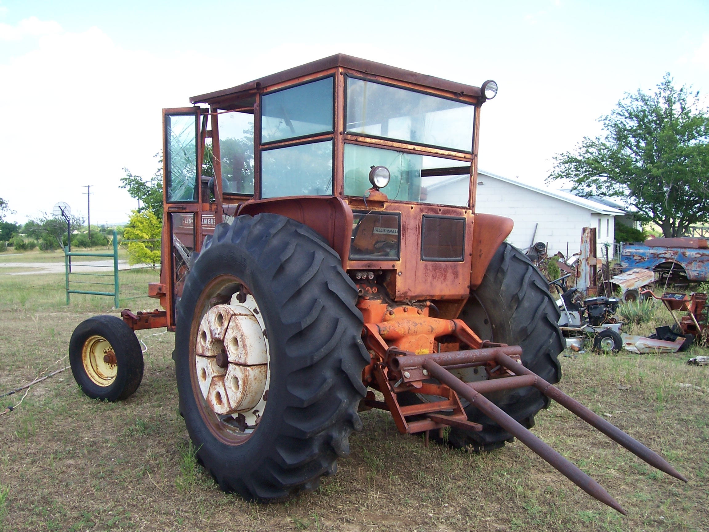

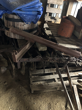

Here's a picture of the bale spike someone had on the D19 I bought.

What are the pins mounted on the brackets underneath the frame for?
JohnCinMd View Drop Down
Location: Westminster, Md
Points: 1438
Post Options Post Options   Thanks (0) Thanks(0)   Quote JohnCinMd Quote  Post ReplyReply Direct Link To This Post Posted: 26 Dec 2022 at 5:48pm
To attach to rams for added lifting strength.

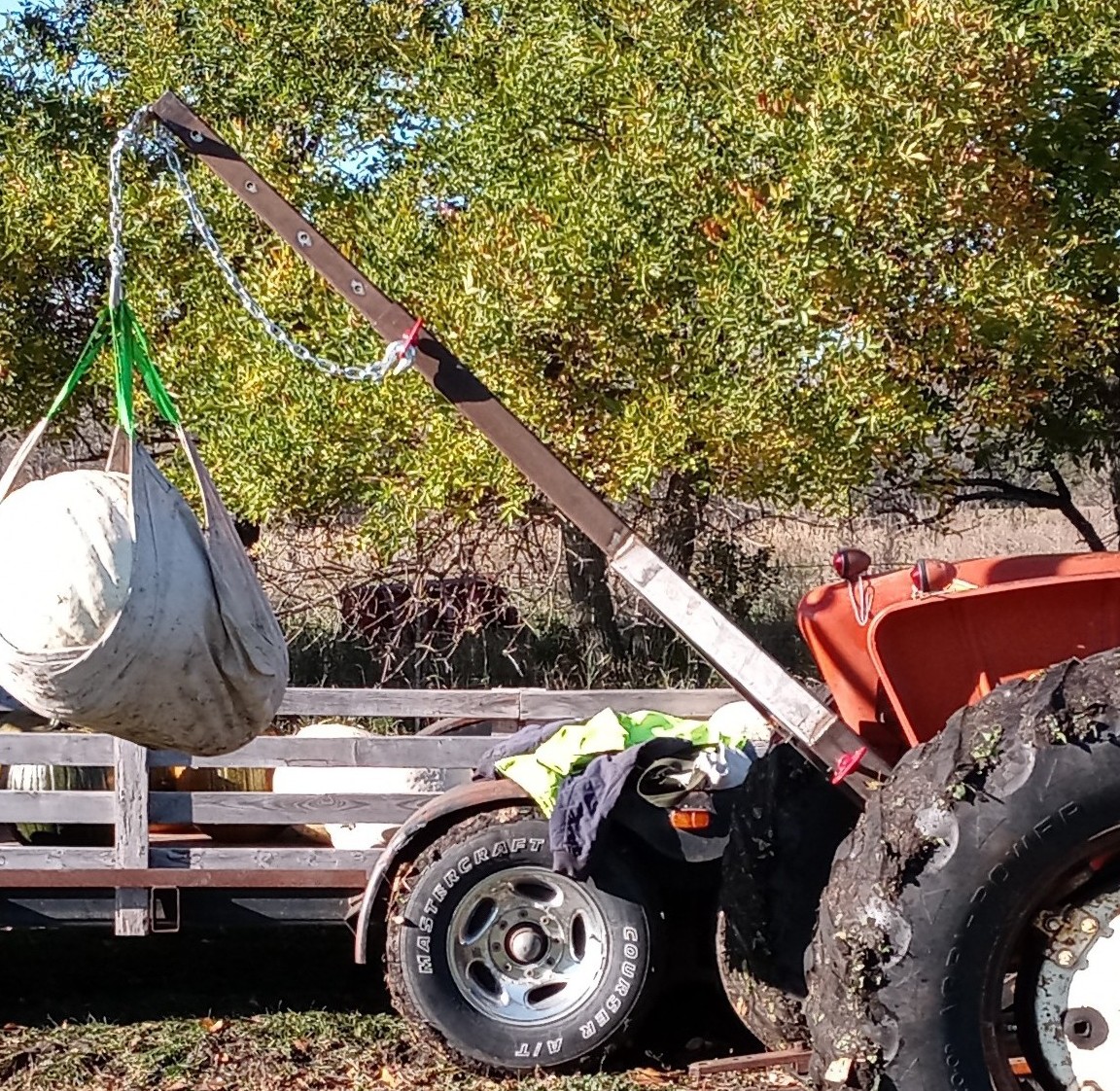

For you purists, this is definitely not original.
This is my farm crane I built a couple years ago on my D17. Mostly built for getting large pumpkins out of the field. Extended fully it is all of 8' above the ground. Haven't used it for anything else, but, was able to lift my #2 3-16 plow with boom retracted.
Going from memory, the tubes that slide over the lift arms are 2"x3" 1/4" wall. The telescoping boom is 2"x2"x1/4" inside of 2 1/2" x 2 1/2" x 1/4". On the end of the boom is a plate with keyhole slots so I can adjust the length of the chain. The chain has regular chain hook on one end, and choker hook on other end.
The holes that pin it to the lift arms are towards the bottom of the tubes to increase lift angle.
