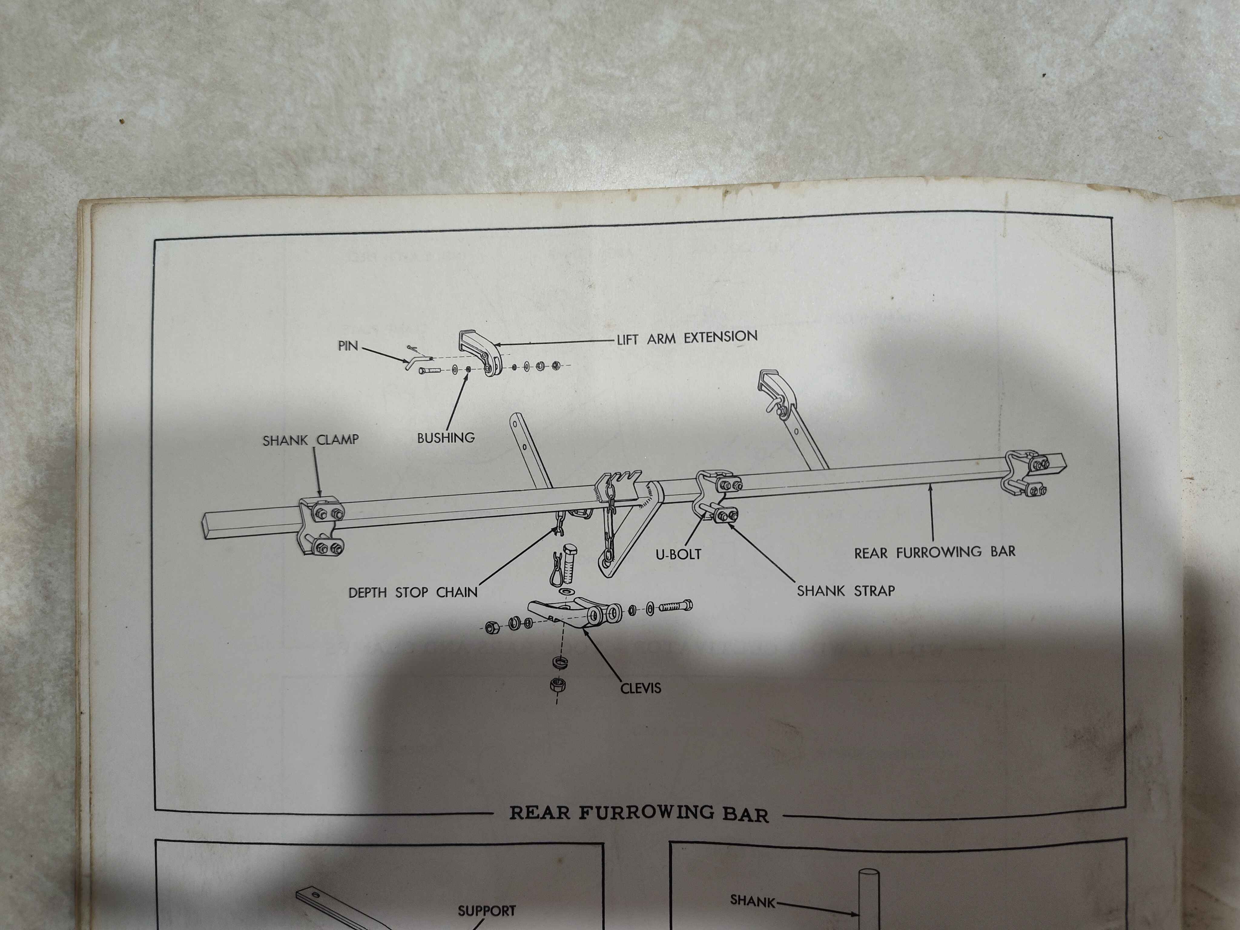

I found a later model WD cultivator manual at the farm. It is for a snap coupler tractor. The furrowing bar as it is called mounts with a special clevis to the draw bar. It only has one lower arm. The description seems to mount the bail to the pins and remove the upper bolts.
Grandpa's bar has two lower arms and no clevis. It think it was before he converted the WD to SC. He bought the WD new in 1948. Looking at it bail is allowed to swing on the top bolts, pins on extensions insert into the pin adjustment holes on the bail. A bolt then secures the extension to a hole at the bottom of the bail.
In both versions a part of the drawbar system in the lower hinge.
