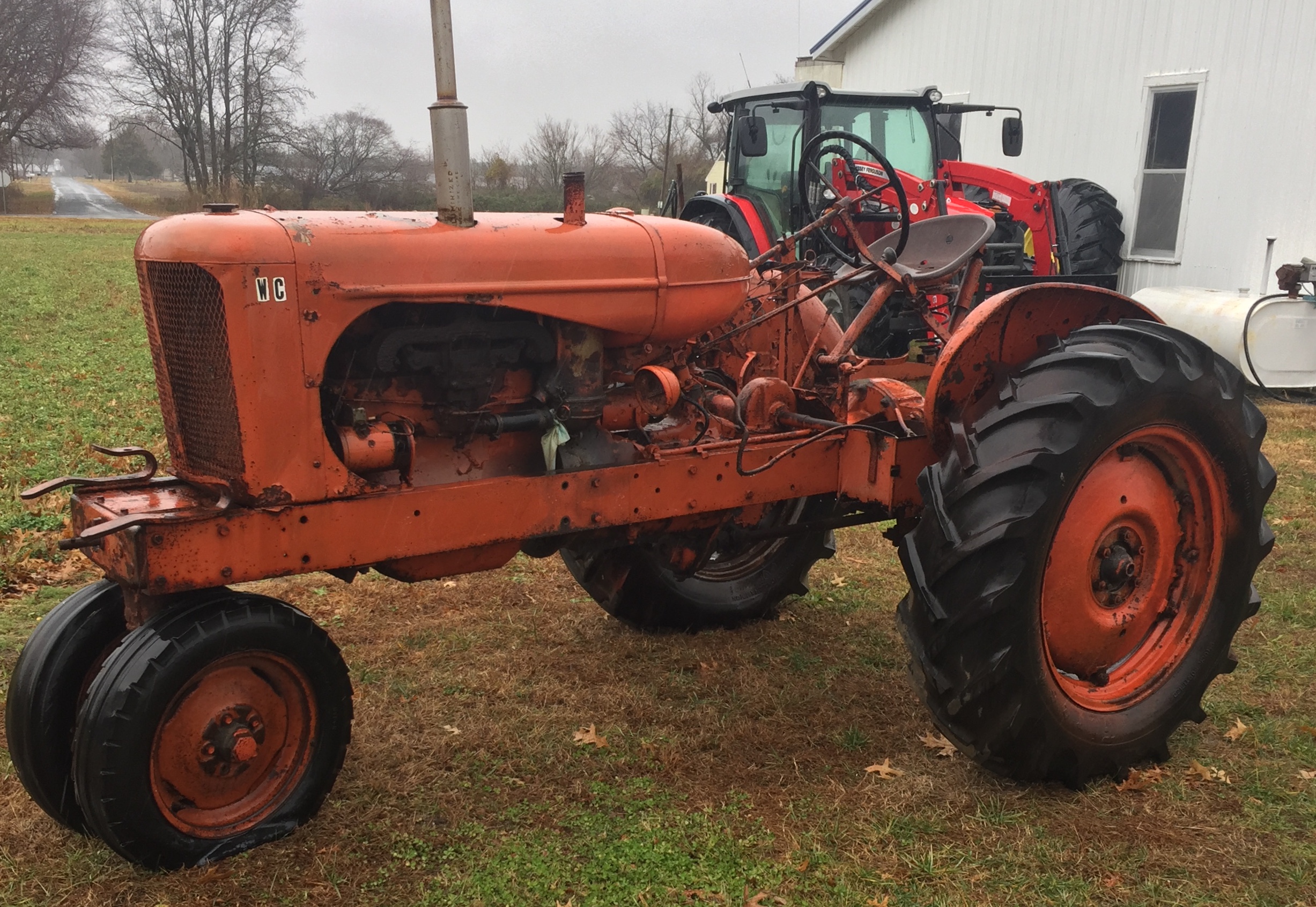

Ok bought a stock original wc for my girlfriend to pull with at 3000 and 3500 3.5 mph its getting 175 govner spring and d17 weights to get the rpms up it’s got 13.6 28 on it now will the speed be ok with 15.5 38 ? I also have a set 18.4 26 I can build light spoke wheels for

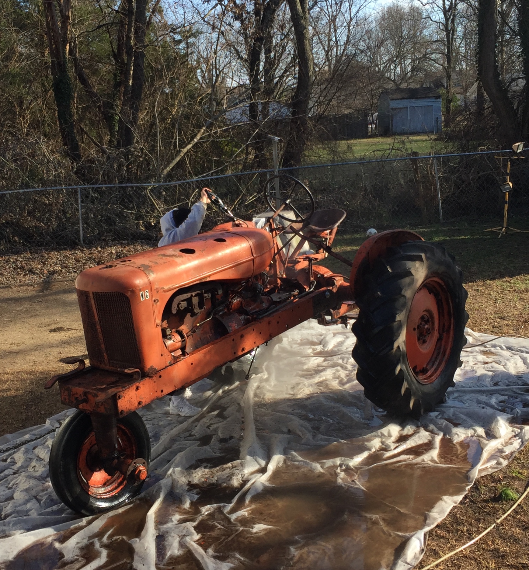

. She’s definitely a keeper she spent several hours Sunday power washing years of grease and dirt off

I ran some numbers for you, using Nebraska Tractor Test info, for tire size and RPM.
The numbers result in the difference between 1300 rpm vs 1750 rpm and 11.2 x 24, WC tires, 43" in dia. But you may have to multi ply these numbers by 1.075, because they list the steel, 40" wheels, with the same 2.5 & 3.5 mph, for first and 2nd gear as the rubber 11.2's.
1st gear stock, 2.5 mph @ 1300 rpm:
18.4x26 = 4.47 @ 1750
15.5x38 = 4.87
2nd gear stock, 3.5mph @ 1300 rpm:
18.4x26 = 6.25 @ 1750
15.5x38 =  6.82
Edited by frnkeore - 17 Dec 2019 at 11:40am

15.5 X 38's on a WC with 30 HP won't work will they ?? You'll kill the engine most of the time in LOW gear.

3.5 MPH on any standard geared WC works just fine with 15.5 x 38 rear tires IF YOU HAVE ENOUGH ENGINE TO HANDLE IT.

Originally posted by bradley6874 bradley6874 wrote:
My question is more will the gearing work at 3.5 with 38 inc tires with more power or is the gearing just to high ....and something else need to change
For your combo, 3.5 mph, will put you at 1370 rpm with the 18.4's and 1258 rpm with the 15.5's.
I think you would be better off, with the stock cam and take the engine to, 4 1/8 x 4 1/2 (240.55 CI), and use a bigger carb.
At least you'll have your power at the 3.5 mph.  I think it would work ok. At 5800 lb, I spin my tires (16.9x28), pretty easy with my stock D17.
Oh, and get the engine to at least 9/1 compression.
