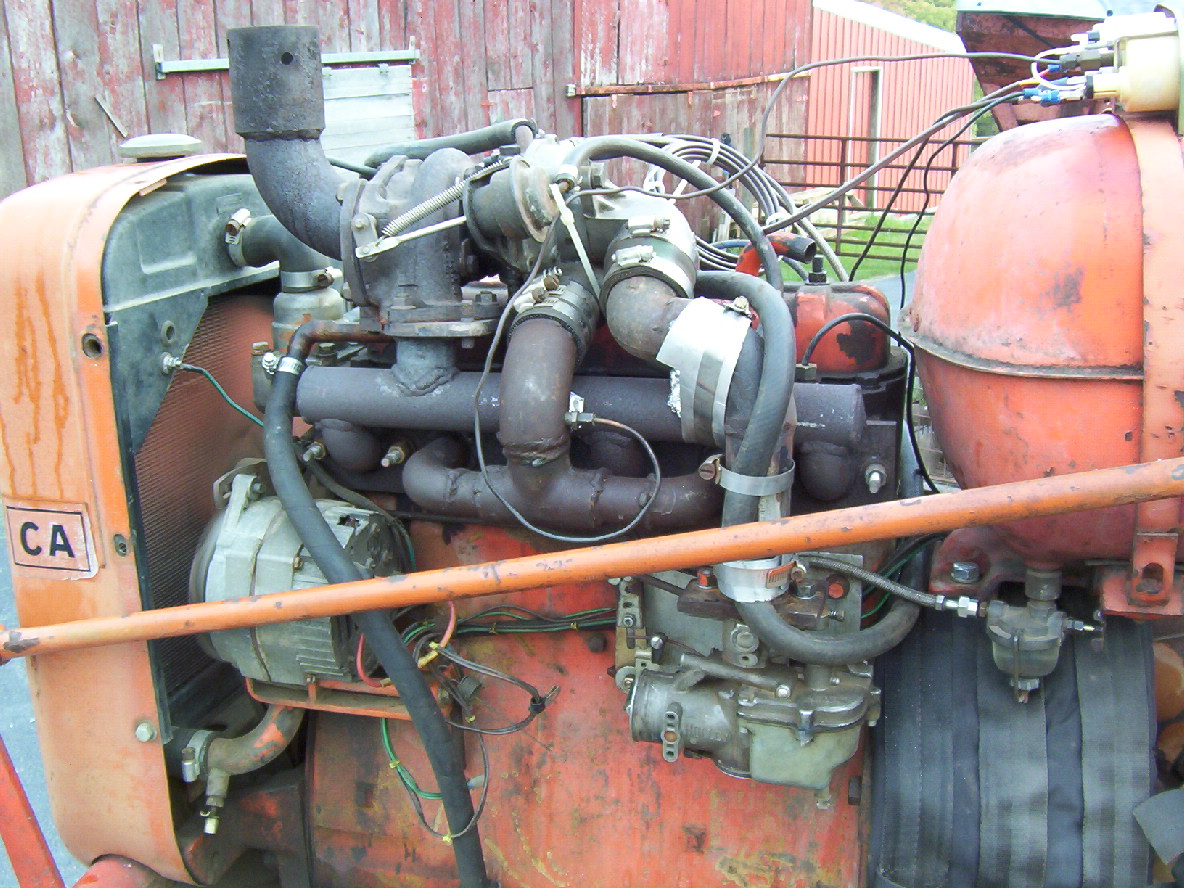

Thank you Paul for the useful information and posting a picture of your turbo set-up. I had been wanting to see how you plumbed the draw-through system, She sure walks that sled LOL.

I can't remember exactly what the seat pressure ended up on the head of the 160 engine in my turbo CA. I kinda think it is near to 60 PSI seat pressure. Then again I run at near 15PSI boost and over 4000RPM. Now with the big two barrel it can breath like it should. I have not noticed any wear in the valve train. I used new OEM stock retainers and keepers. I do use Amziol 15/40 in both of the pulling CAs. This is when I still had the single barrel up draft on. to see how it runs now with the two barrel watch this.   http://youtu.be/GXU6b43E6ro
