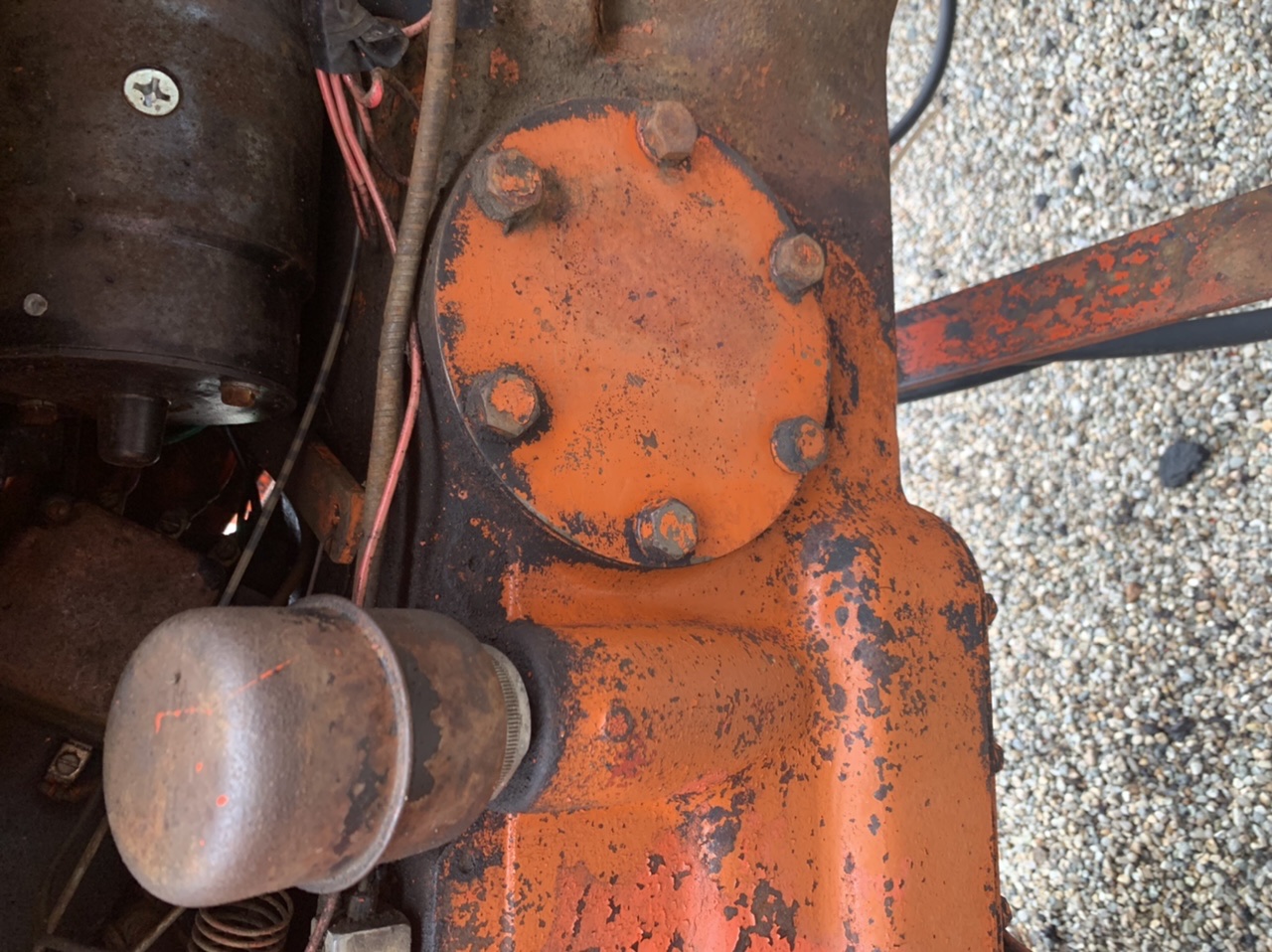

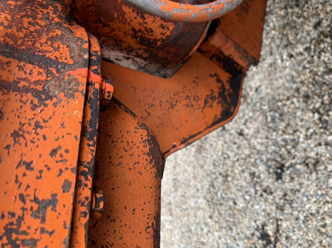

Old post but on topic
We’re early d15 series 1 1961 models still PO1. Just power wash and started sandblasting and stripping and it appears po1 is the paint. Heard most are po2 but can someone confirm if 1961 d15 first couple thousand serial numbers were pointed in original po1?
Thanks so much

The D-15 was when the "change" was made. There are none painted the old orange from the factory. New grille screen was painted crème as was the front and rear wheel centers. Crème paint and Persian Orange #2 went together in mid to late 1960 when the new D-15 was introduced.

Dr. Allis is right.  No D15s were ever PO1.  It was the first tractor to wear PO2 paint when it was introduced.

Thanks guy
It must be so old it looks like po1
Or old orange. I call it pumpkin orange
