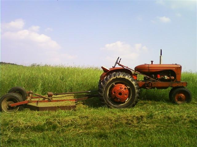

Post Options Post Options   Thanks (0) Thanks(0)   Quote JohnCinMd Quote  Post ReplyReply Direct Link To This Post Posted: 10 Aug 2012 at 8:21pm
i use a 5ft pull behind with my WD. It's a lot of fun, except when I have to steer around the perk test holes.
JohnCinMd View Drop Down
Location: Westminster, Md
Points: 1438
Post Options Post Options   Thanks (0) Thanks(0)   Quote JohnCinMd Quote  Post ReplyReply Direct Link To This Post Posted: 10 Aug 2012 at 8:23pm
I did put on a PTO clutch since that picture was taken.

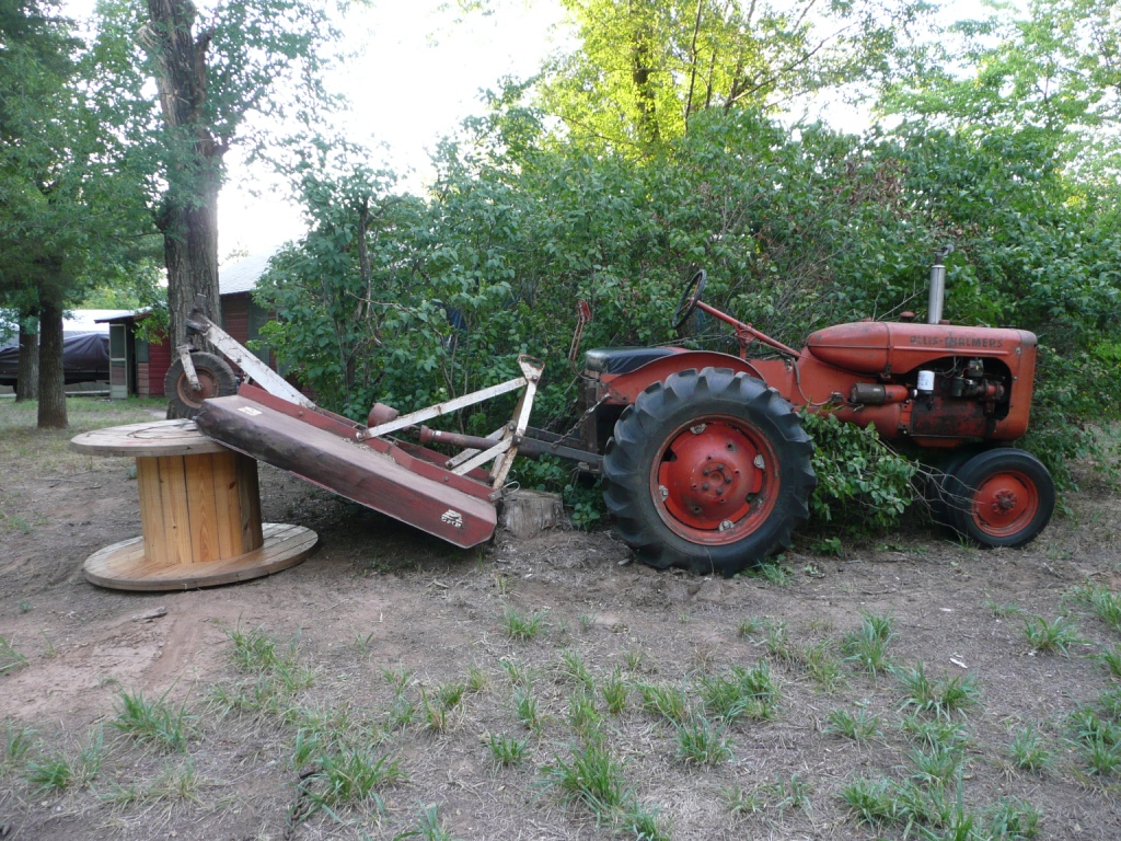

Dave, you are talented sir! I'd get all confused and end up peeing in my beer! Course, the land aint quite as flat around here. We stay pretty busy dodging rocks, holes, and gulleys.
Anyhow, here is a pic of my C with the trailer bush hog that my grandad used behind it. Driveline needs rebuilding in a bad way. Flops and bangs all the way through any turn over 5 degrees. Does a nice job though.
