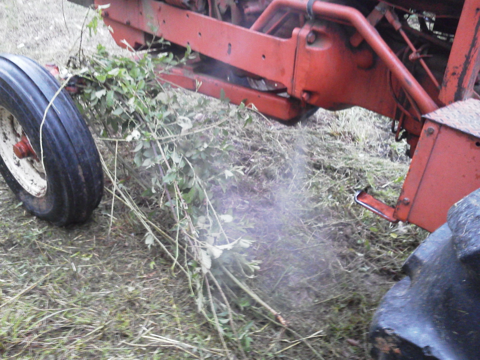

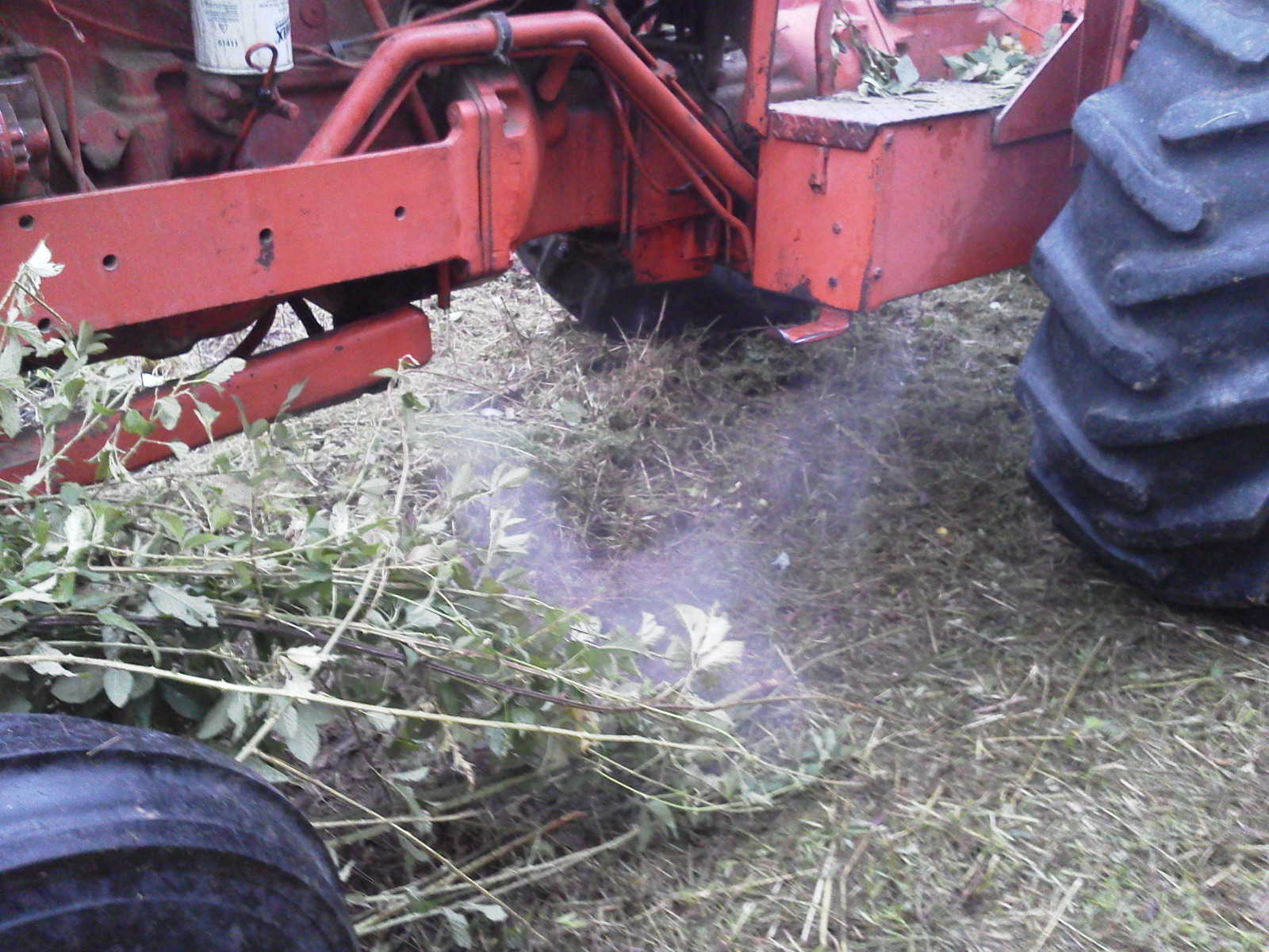

I have had this tractor since 02-2011. I noticed a little "blow by" and a little blue smoke when I bought it. But for $2700 I bought it. Fast forward to 07-2012 and about 40-60 hours later I have been noticing more "blow by" coming from the vent tube and the dipstick hole. Most noticeable at idle. Exhaust has not changed, just mild white-blue.
Past few times I have checked the oil it had water drops on the upper part of the dip stick. I chalked it up to I had it outside in a rainstorm and some water got in and the blow by vapor and droplets were just the engine boiling it out. I checked the dipstick today and had gray sludge on the upper half of the stick and gray sludge in the crankcase vent tube. It tasted positive for the green stuff. Not the smartest thing, but cheaper than an oil sample!
How do I check to find out where this is coming from???
I figure it could be head gasket, sleeve erosion, or sleeve o-ring. I do not even want to think of a cracked head. It did get hot the other day, leaves plugged the radiator while mowing +7' tall weeks, it boiled some water out. I put about 3 gallons of 50/50 in Saturday. Ran it 1/2 day Sunday, ran good, just had white vapor coming from crankcase. Just put a new Stewart Warner Oil Pressure gauge on it. 35-40 at idle, 55-65 at rated speed. At least that is a plus. Temp gauge broken, next on the list.
Picture of the vapor.
Thanks, I need to fix it soon. This is my big iron.

The white component in the exhaust is steam. Blue is oil. Think hole plugs in the head, head gasket, sleeve o-rings. Antifreeze isn't a good lubricant additive. It should be accumulated at the bottom of the pan, out of reach of the oil dip stick. It should come out first as you loosen the drain plug.
