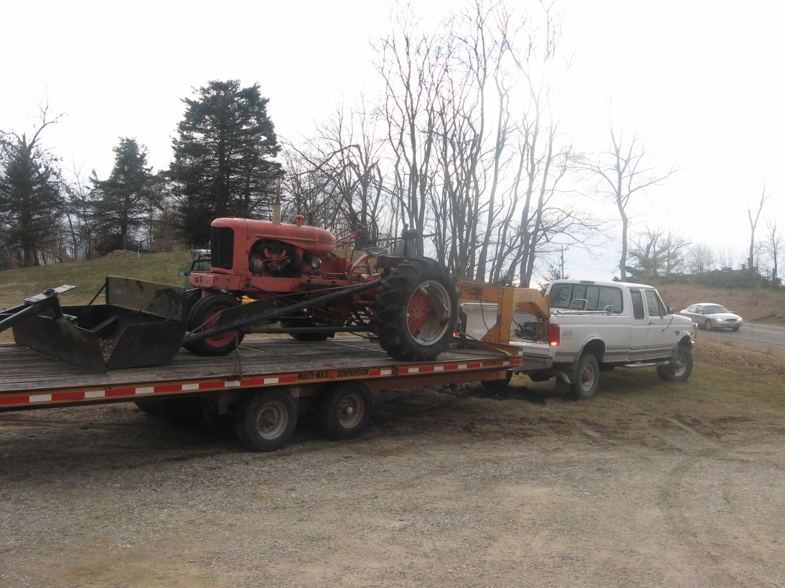

Hi all, my father recently gave me his WD45.  It was rebuilt about 20 years ago and has sat idle much of that time.  I trailered it back and have been working on it since.  I have gone through the electrics, installed an alternator and coil.  It is now running and I have been using it on our acreage.  I picked up a worn wide front end that I hope to give new life to.  I would appreciate any advice on what to check on the tractor since it has been sitting so long.  Here is a picture of when I brought it home, I hope to include more pictures of the front end rebuild as I complete it.  Sorry if the picture does not load correctly)

looks good. and welcome to the forum

   Welcome ! That loader looks like it will go way on up there !

Yup, my dad told me that the loader bucket would go almost over my head if I'm not careful.

great looking tractor, with a loader to boot... I wouldn't be going very high with the loader, ya might get in 'over your head'  : )

I agree with everyone else.  Basically if she is running well, then just change ALL the fluids, and you should be good, these 'ol girls just never gave many problems, if you kept up with maintenance.  As for putting a wide front on that tractor, you might want to check your clearance between the loader arms at the point of the front axle, I don't think it is going to fit.

Nice lookig WD-45.
I agree with Orange Blood - that loader  will not work with a Wide Front End.
No place for the wheels. You need an Allis Model WD9 with an arched boom.
As others said, change all the fluids.

Pretty nice looking tractor you have there, Tires look very nice on the rear.

My tires have virtually no wear but they are weather checked quite a bit. I'll just live with them like that for a while. The sun has taken its toll on the paint as well. It was once repainted and looked great but years in the sun has taken its toll on the paint as well.
