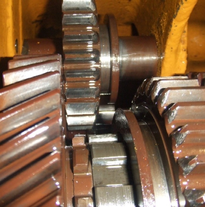

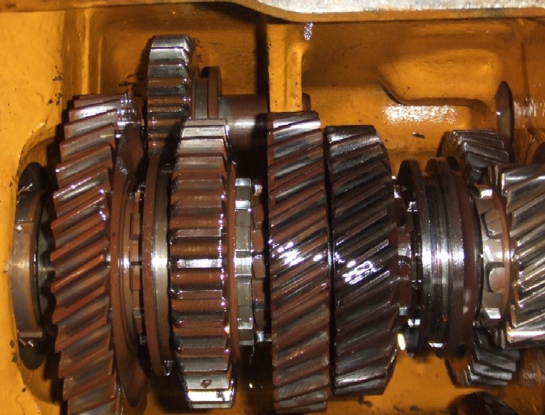

Here is a picture of the gears in neutral and also the top cover with shift forks in neutral.
Thanks for your help.

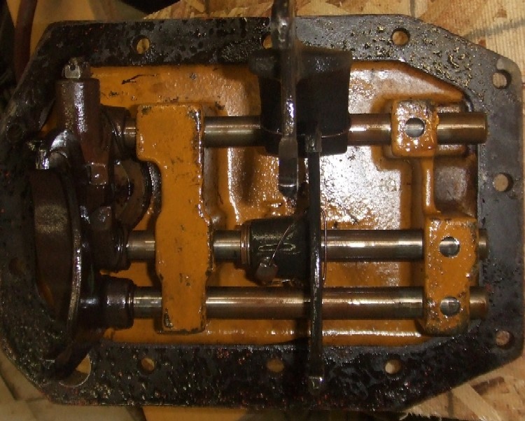

shifter forks in neutral
Edited by pre64 - 06 Jan 2012 at 7:40pm

Best I can figure,when 1/2 sliding collar is slid back to 1st  positiion it is engauging reverse  idler which means reverse idler is not slid back far enough to clear.Can you position things with the top off to get reverse idler out of the way? I can't remember how this works and the pics don't let me see enough,but the idler has to engauge both counter shaft and straight gear on 1/2 collar to get reverse.doesn't the 1st gear position have the 1/2 collar spinning the reverse idler since it wouldn't be engauged with the cluster gear?If so,the idler still has to be reward enough to not engauge the counter shaft?. I'm as confused as you now! Something don't add up. I can't see the sleeve on the idler shaft to the rear of the idler but that don't mean it's not there.
Points: 22554
Post Options Post Options   Thanks (0) Thanks(0)   Quote DrAllis Quote  Post ReplyReply Direct Link To This Post Posted: 03 Jan 2012 at 11:48am
With the reverse idler gear shoved rearward as far as it will go, you should be able to "spin" it freely.....if it is still engaged with the gear on the lower shaft, there is an assembly problem with that lower shaft and gear and spacers??

If that is the case then we have found the problem. When I slide the reverse gear all the way to the rear, looking down with a flashlight it is still engaged by at least a 1/4" to the lower gear. I will send a picture of it as well. Not sure if you will be able to see it or not.

 Is the bottom reverse gear installed so the rounded edges of the teeth are rearward so they mate with the rounded teeth on the idler???

Yes I believe so. The other side of the gear you can see in the picture above and it is sqaure on the front side.

Looking at the wear on your gear train, I imagine one of the spacers on the counter shaft is either to thin, or for some reason worn down, which has allowed the reverse gear on the counter shaft to move rearward, only the thrust on the remaining gears due to the angled teeth keeps them in line.  It' either that, or as you suggest there are different spacers between series 1 and the rest, don't know the difference but if it has been torn apart, the correct ones could have been swapped.  It does appear in the parts manual that the spacer ahead of the revers counter shaft gear is narrower than the one behind it, by maybe a 1/4" or so, so if they were put back in the incorrect order, there is you problem.

Yes I too believe the spacers on shaft are mixed up in their order. I plan on splitting it today if all goes as planned. I will be posting the results and pictures if possible so all can benefit from this. I certainly appreciate all who have helped.
