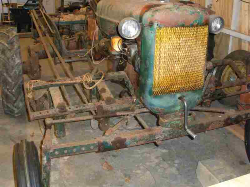

Thanks Brent. I have worked on the tractor before, it is older than me.
The hated alternator is actually my handiwork.
I found a picture. I hope it uploads OK. I just dragged it into the window.
What can you A-C people tell me about it?
I see rust, (even the oil filter) evidence of original orange paint. Adjustable axle
and rear wheels set wide. Under hood muffler. Are the cultivators AllisChalmers or
third party?  Seat is shot. Homemade battery box, Bosch magneto. Replacement 12 v lights. New front tire. The tractor was stored in a humid greenhouse. Stuck in the mud.
Pulled it out with the other tractor (an AllisChalmers 160 in original A-C orange)!
It had rusted a lot since I last saw it. So I rescued it into the garage.
I went wild with rust buster oil. I had put some of that in the spark plug
holes, then ATF some days later. Hand crank is new, it cranks easy.
The gas tank is the type with the exposed rear tie down strap. I have mom
looking for the owners manual. I am sure the serial number is written in it. Actually
green isn't that bad of a color. I can't recall it being orange. I was like age 4 when it got painted green. Is this a sand blast candidate? What does it take to get a 100 year paint job.

Ok, maybe now I have a picture of the 1948 C
