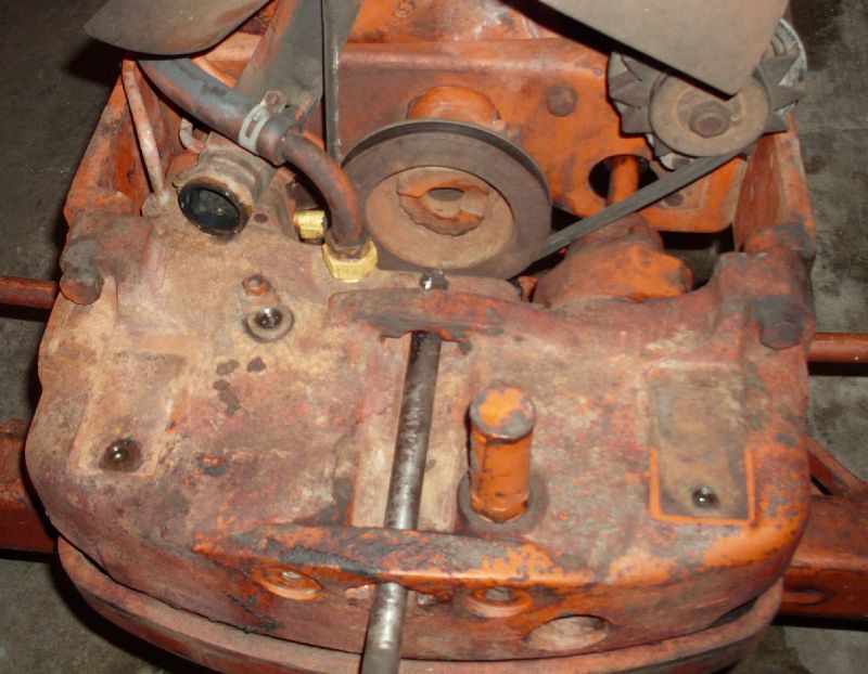

So I'll start by posting pix of what I'm starting with here (skipped removing tin and radiator, flushing engine and degreasing), so follow along... this is gonna be fun!
DaveKamp View Drop Down
Joined: 12 Apr 2010
Location: LeClaire, Ia
Points: 6117
Post Options Post Options   Thanks (0) Thanks(0)   Quote DaveKamp Quote  Post ReplyReply Direct Link To This Post Posted: 22 Apr 2011 at 3:21pm

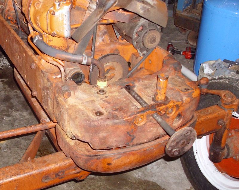

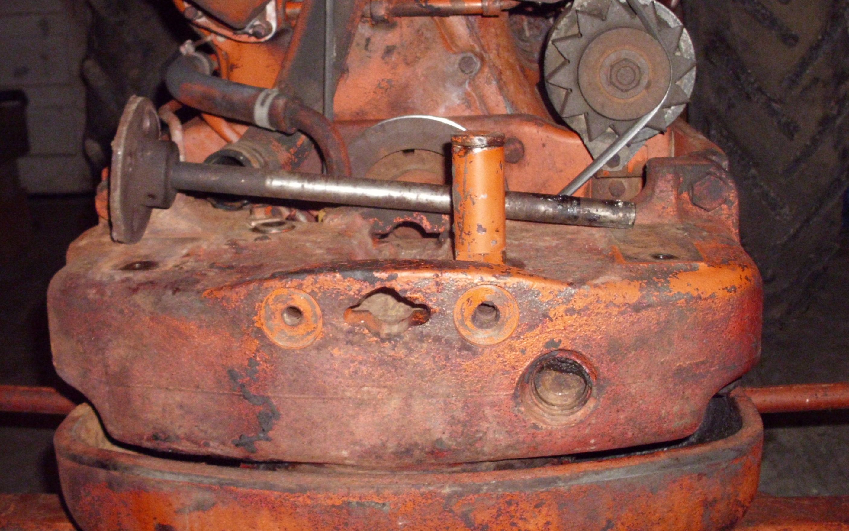

Here's what it looks like right now...
The shaft sitting on top is from an aftermarket kit that uses a 3/4" keyed shaft to a 4-bolt coupler, and the other end goes to a U-joint connected to a pump on a big bracket.
There's plenty of room to work and think here... and I think I have a really slick solution.  I gotta get this front pulley out, and once it's out, slide in the 4-bolt coupler pulley, but once this one is out, I'm gonna take some measurements, and see if there's a slick way to make a coupling that'll work with a stock 2-bolt setup, in such a way that we don't hafta disassemble anything or fish any crazy tools in there to slip the whole kit in.

Yes, the shaft is sitting in there backwards.  I had it slid in there to get a rough idea of about how far the reach of this other 'kit' was.  Hole for the crank is about 1.1", which will be somewhat important later... but not right now.
Edited by DaveKamp - 22 Apr 2011 at 3:25pm

There is room to get the pulley out without moving the front casting forward?
Someone put a picture of one of those pulleys on here after you got that first batch of stuff from me. I didn't know there were different pulleys. I figured they all had threaded holes in them.
The only hiccup in getting the pulley to you was my daughter's cell phone battery was dead last night. She looked at it the middle of the morning today.
The pulley that is coming your way has provision for hand crank. And the threaded holes.

E7018-  No hiccup- Marshall got it done- it's in my in-laws' car, will be arriving about 2 hours before dinner tomorrow.
No way to get it out of there without pulling the bolster-  not enough clearance for a puller, and tryin' to lever it out will just bust it up.  Whatever I come up with for an improved design, however, will be able to work with either sheave... and able to be installed without taking ANYTHING apart...  Dunno how, but I'll think of something.
I'll have it all apart and ready when it arrives, buddy will help me get it pushed in, and back together, the one comin' out will be in the box heading your way on Sunday afternoon, and we'll get it figured out from there, thanks!!!!

It looks to me like you might be able to make a puller for your situation by running a long threaded rod thru the crank hole, install a couple of heavy washers and a nut on the front side of the bolster. I also like to use a kingpin thrust bearing to reduce friction.
'course you still gotta figure a way to "latch on" to the pulley in a way that won't take up too much space.

After looking at your pictures for a second time, it looks like there might not be enuf room to pull the pulley as I suggested. However, if there is enuf space to get it started, you might be able to pry it off the rest of the way.
That's if there is sufficient space to even move the pully forward enuf to clear the shaft.

Brian-  pulling it isn't a problem, but there's only about 5/8" clearance between end of the flange and the back end of the bolster... and there's well over an inch-and-a-half of purchase on the pulley flange, so no matter how you look at it, either the bolster needs to come out, or the engine needs to come out, in order to get that sheave out.
The 4-bolt just arrived in the in-law's car, and the bolster bolts are tight enough to bend a stout box-end wrench, so this is gonna be a challenge to my post-op body.  Both the original, and the new pulley are keyway type... and if I remember correctly, my '48 and '39 B and '37 WD are both keyway.

Okay, it took an awesome breaker-bar setup, but I got the front bolster bolts broke loose, and it's sitting on some splitting stands with the front wheels just barely off the floor.  I have a 'track' for the axle yoke to lay on, while I slide the whole works forward far enough to swap the pulleys.
Now, I need to disconnect the steering shaft.  It LOOKS like, to me, that the easiest way to do it on the D17, would be to disconnect it at the joint back on the engine bellhousing.  Question is, though... is the pin that holds the yoke in intended to be sacrificial?  It looks mushroomed on both sides, so before I start beating on it, or grinding it, I'll check with someone who's done this before...
Next... the pivot pin on the axle stabilizer yoke... back under the flywheel... what's the most sensible way to unhook that?  I see several bolts, as well as the pivot pin, and don't really see an obvious method for taking that apart in a minimalistic way.
Finally, the power steering lines... which ones, and disconnect where, in order to make the least mess?

I have heard people say the pins are tapered, they are not, at least on the WC and WD. It's a straight nominal size pin with both ends mushroomed into a chamfer. I intended to put roll pins back in the WC but my hired help left the crusty old bolts I stuck in to move it around the shop. Add that to the things to do list.
