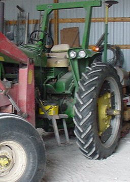

Chuck,  Here is another approach that was used on a WD.
Gary in da UP View Drop Down
Location: EUP of Mi.
Points: 1885
Post Options Post Options   Thanks (0) Thanks(0)   Quote Gary in da UP Quote  Post ReplyReply Direct Link To This Post Posted: 23 Mar 2011 at 6:19pm
 I like the fact that tractor has a fire extinguisher mounted on it. Just a good idea, whether pulling, working or on a tractor cruise.
