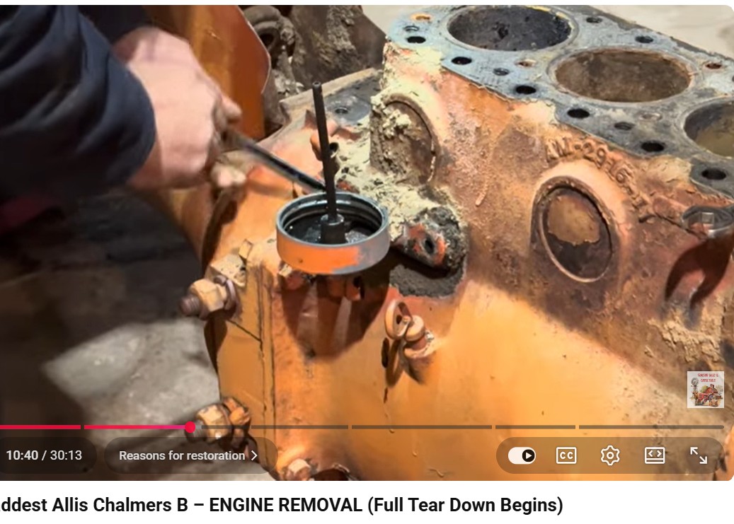

to expand on Dr idea... i think there are 3 freeze plugs on the side of the bock behind the oil filter and mag.... you might knock one out and take a look !!!
Isn’t that an oil galley behind those 3 big plugs? Not water ?
Anyone would be wasting their time removing the soft plugs shown, they any give acess to pushrods and lifter tops.
