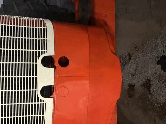

Does anyone have a source to obtain the plugs to fill in holes on a D19 front grill? I dont have a front driven oil pump, so no need to have these holes showing. TIAuploads/24926/IMG_0380_2026-06-27_08-23-21.jpeg

The grille screen plugs are the same as any D-15, series two D-17 and newer, and any D-19. You could lay the grille screen on its face and RTV silicone the pre-painted plugs on the back side instead of welding them and burning the paint. Those round plugs must be D-19 only.
