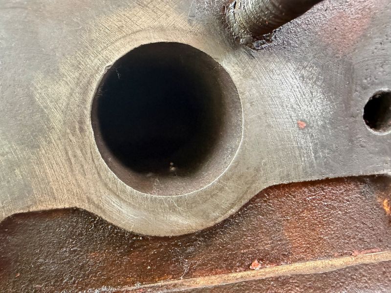

I had replaced the manifold on my D17 IV probably 5-6 years ago.  At the time, the old one was severely rusted and unusable, so I bought a new one, American made it said.  I was careful installing it, with clean surfaces, and I used some copper coat on the gaskets.  Anyways, it started leaking on the two center exhaust ports last year, and I finally got around to putting it in the shop.  When I pulled the manifold, the two center round ports were in very rough shape on the manifold, and not the greatest on the head itself.  It is almost as though the metal gaskets just welded themselves to the manifold, and somewhat to the head.  I gave up trying to clean up the manifold ports, and ordered another one. I figured a machine shop would cost more than the ~ $200 for a new one, plus I need the tractor back in service and don't have a local shop to work with.  The ports on the head I think I have pretty well cleaned up using a wire brush and fine sandpaper, but they are still a little pitted.  I think with more work they will smooth out.
I know I ran it longer than I should have with the two center exhaust gaskets leaking.  I'm just wondering how best to prevent this again on the new manifold.  Are gaskets today just junk, and don't hold up?  I had used copper coat, just because it seemed like a good idea, but perhaps they hold up better just dry?  The intake and the outer two ports are all in perfect shape.  It is the center two round ones giving me trouble.  I never checked the last manifold for flatness, but short of sending it out to a machine shop, I can only check it with a decent straight edge for obvious warping, which I will do when it arrives.
Anyone with advice on how to get this new manifold to last more than a few years?

Damage/pitting to the head isn't good and will shorten your gasket life. I have been preaching for years that the manifold nuts must be retorqued (35 - 40 ft lbs) when COLD probably 5 or 6 times to get the gaskets to crush into shape. So, if you used the tractor 5 or 6 days in a row, every morning while COLD the nuts need to be retorqued. Also, start with light tightening of the two END nuts to "square" the manifold to the cylinder
 head and then alternate with the other four nuts while working up to whatever the proper torque is. Gaskets need to be DRY !! Clean off the side of the cylinder head pits clean and smear some high temp gold color RTV on those pits and then assemble the manifold so the metal gasket holders seal against this RTV. Again, gaskets dry and multiple retorqued many times when COLD.  *** The torque spec of 35 - 40 ft lbs is for a healthy manifold. Be cautious if the manifold is badly pitted or thin on the ends as you might break off an ear.

Thanks for the advice.  I was definitely negligent on not re-torquing enough on the old manifold, and will re-torque this new one frequently when cold after a short heat cycle, and keep at it until they don't move anymore.
I'm not finding a torque spec for the manifold bolts, but will keep searching.  I did find a spec of 30-35 ft lbs for a WD.  I plan to use anti-seize on the nuts, so that spec might be a little high for a lubricated nut.  I would think just a common sense "pretty darn tight" spec with a regular length wrench would be enough, or should I keep digging to find an exact spec and use a torque wrench?

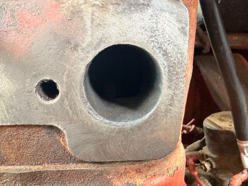

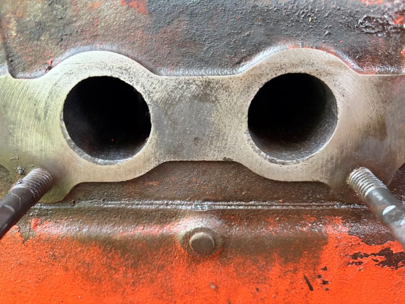

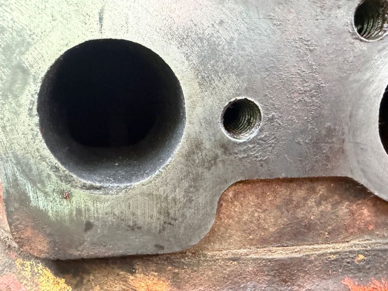

The new manifold will be in tomorrow, and I've been cleaning things up, using various grades of Scotchbrite type pads on a drill.  I'm not done yet, but here is a picture of the ports.  It is cleaning up better than I thought.  Some of what I thought were pits were leftover gasket welded to the head.  There are some pits though.  I have little faith in the gaskets that will come with the manifold, if they are some unbranded Chinese junk.  But there isn't a lot of choice on the gasket set, and even if I got one from NAPA they probably all come from overseas.
Anyways, I'm planning to follow Doc's advice and "go dry", unless everyone thinks the pitting is too deep.  The intake ports are in great shape, and polished up nicely.

Every one I do I coat the manifold surface as well as the head surface of the gaskets with high temp copper rtv. Never had one leak yet

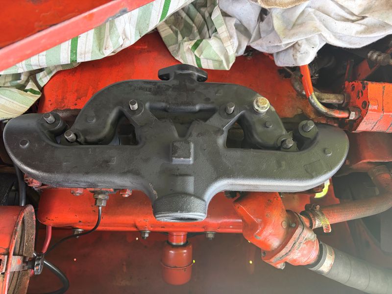

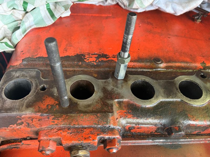

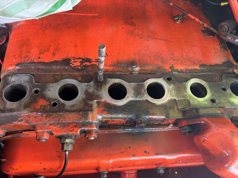

Of course, installing the new manifold was going way too easily.  I had installed new studs with the previous manifold, so they are only a few years old.  I had installed them with Permatex 2.  The old manifold said made in USA.  The new one is made in Taiwan.  It is about a 1/2" thicker than the old one, and the old studs are just a bit too short, so I have to install the new studs I ordered with the new manifold. Well, of course 3 came out easy, 2 were difficult but yielded once I explained to them that they had to move.  The last one is no go.  With major vice grip force and heating with MAP gas cycles, and penetrating oil over a few days, I have gotten this one to move a bit.  I can get an 1/8 of a turn on it back and forth, but that's it.  I'm limited with the leverage I have with the vice grips, and they slip and just eat up the stud.  The force needed is well beyond double nutting or anything.  So close, but so far!
I have no intention of damaging the head or having the stud snap off flush.  I've been cautious so far in applying heat.  However, I am starting to consider cutting the stud off about 3" out, and welding a nut to it.  Of course, there is no guarantee the stud still won't snap off, but at least I would have some control over moving it back and forth a little, and along with oil, perhaps I can coax it that way.   Another option might be to cut the stud, and weld a new one of the correct length to the stud.  I would have to position the weld so it is in the free space between the head and back of the manifold before it enters the hole.  If I'm super careful with the welding, I'm assuming that much heat won't damage the head or the head gasket?  I'm being a little overly cautious.  I just wish the little critter would back out, then I could finish the project.
Any ideas or suggestions on how to get this stud out are welcomed.

Question, how much of that stud is still inside?  Take one of the other studs you removed, and hold it beside the holdout...

There isn't very much inside.  By the threads on the other studs, I would say maybe 1/2" or a little more.  I'm surprised it is giving me such a fight.  I had installed it with Permatex 2 to seal it, and it is only a few years old.  The other studs weren't particularly rusty or anything.

I would cut it off at about 1/2" above the head, place a 1/2" nut over it and weld the dickens out of it. Then as soon as it cooled a bit (not TOO cool) I would spray it with PB Blaster and use a long handled box end wrench to turn it back and forth, spraying it liberally (you know, the way the gummint spends your tax dollars) all the while with PB Blaster.
The heat followed by rapid cooling will shrink the stud and help loosen it.

There are times when the 1/2" air impact wrench can really be your friend. This might be one of those times. I would screw on a steel nut as far as the threads of the stud will allow. Then, weld up the threads so the nut cannot back off. With penetrating oil and maybe some heat, carefully use a 1/2" impact wrench while turning down the power and throttling the trigger to work the stud out of the head. It's a 7/16" stud and it can take quite a bit of easy hammering.

Heat with your choice of weapon, and as it cools, stick a bees wax candle against the stud.  Something about how bees wax wicks its way into threads makes it the better choice...  Have done the impact trick, too.  hit it both directions, to get the stud moving...Wink

What a pain the neck this project has been.  I planned it would be a few hours to pull the old manifold and put the new one on with fresh gaskets.  Anyways, I welded a nut onto the end of the offending stud.  I used a 1/2" impact wrench with 100 lbs of air.  Back and forth, no movement, until finally the stud snapped in the middle.  I decided not to chance welding another nut on and having it snap off flush, which I figured would really ruin my day.  I cut the stud at the end of the threads coming out of the head, and used a 7/16" coupling nut, along with a lock nut.  I cut and threaded one of the new studs for the correct length.  Overall, I lucked out that there was enough of the old stud to work from.  Odd, that I had replaced all six studs only a few years ago, and all had Permatex on them to prevent leakage.  I have no idea why this one decided to fasten itself to the head like that.
I am following Doc's advice and installing the gaskets dry.  They came into the world dry, and dry they will go out when their time comes.  I think the port surfaces cleaned up nicely and should seal.

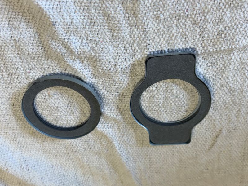

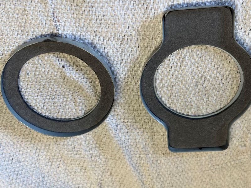

i use two if they are all thier probley not so critacal  with new surfaces the major deal is to retorque after each heat cycle while stil hot until they stay tight even if its four or five times

With the gaskets no longer having asbestos in the fiber gaskets and you put them on dry, you already have the fibers you'll need for next time.

I wonder if the gasket kit also fits a D-19 ?? A D-19 would require the two special "end" gaskets and 7 round gaskets. A WC or WD manifold require 6 round gaskets total. A WD-45 and D-17 require 4 round and two of the special end gaskets.

the last several kits that i have bought have just exactly two gaskets for each metal piece  but they also are alot thinner than the ones that i used to get  aleast it seems like that to me

The aftermarket gaskets are half as thick as the OEM Allis ones, my guess is they send 2 to compensate for the difference.

It's being said that there "double" the gasket count. So, are the end gaskets round?? like the other six middle location gaskets ?? or are they the special end gaskets and if so, are they doubled up in quantity also ????????????

No one could give me a straight answer on why there are double gaskets.
With double gaskets, the metal cup is almost full.  I couldn't see any compelling reason to have such a thick gasket, and figured it would only be easier to blow out over time.  Plus, for a dry installation, the metal cups wouldn't stay on the stubs of the manifold ports, so it was difficult to hold them and push the manifold on at the same time.  The single gaskets in the cups seemed more normal, so that is the way I went.

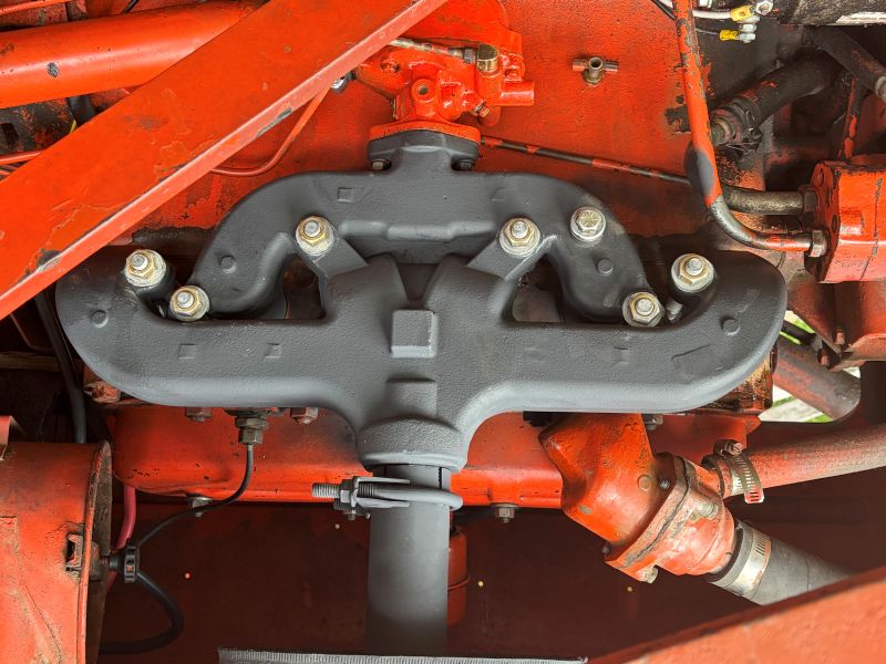

I am amazed at how long it has taken to bed everything in.  Doc and everyone's advice was spot on in terms of re-torquing when cold after a heat cycle.  I think I have re-torqued at least 5 times now, and it is finally starting to not require much when I re-torque the nuts.  I'm amazed at how much it has moved after the initial torqueing.  The first couple of times, some of the nuts almost felt loose when I torqued them again.  The new studs have a fine thread on the manifold side.  Also, I used anti-seize on the nuts.  Doc recommended 40 ft lbs.  I always see a recommendation of about a 30% reduction for lubricated nuts, or 28 ft lbs.  Given the fine threads, and not wanting to snap the ears off of the ends, I settled on 24 ft lbs as a reasonable torque.  That seems plenty tight for this setup.  I'm going to continue to re-torque it as long as I have to, until it finally settles in for good.  I imagine thicker double gaskets would have taken even longer to settle in.
One other thing I did was buy a new muffler, even though my old Nelson muffler was in good condition.  I bought the Nelson muffle several years ago when they had a run available re-making for a while.  The problem was, the Nelson had a 2" inlet and a 1 1/2" outlet.  It always seemed like an odd setup, and I assumed it created some backpressure, and maybe contributed to continually blowing the exhaust gaskets.  The new muffler (a Stanley unfortunately), but at least has a 2" inlet and outlet, so I'm guessing it will be freer flowing, even if it sounds lousy.
My quick 2 hour job is finally almost done, 2 or 3 weeks later.  Anyway, she runs like a top and sounds a lot better.

So, knowing what you do now, is it any wonder the gaskets fail when they aren't retorqued cold several times ??  Even one cold retorque would be better than none.

I've learned me lesson on multiple re-torquings.  I feel like I should write in on a blackboard 100 times.
I wonder where all the movement is coming from?  The gaskets were about 0.050" thick.  I would think they would compress pretty fully on the initial tightening.  But I had some fairly loose nuts even on the third or fourth tightening.  I don't think the studs were stretching.  Anyway, interesting.

It's something we never really worried about until about 35+ years ago when asbestos was outlawed.
