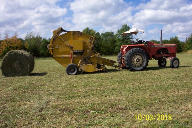

SteveMaskey(MO) View Drop Down
Location: Wellsville, MO
Points: 627
Post Options Post Options   Thanks (0) Thanks(0)   Quote SteveMaskey(MO) Quote  Post ReplyReply Direct Link To This Post Posted: 27 Aug 2025 at 10:32pm
My XT and baler since 1988. Rolled up about 400 this year
