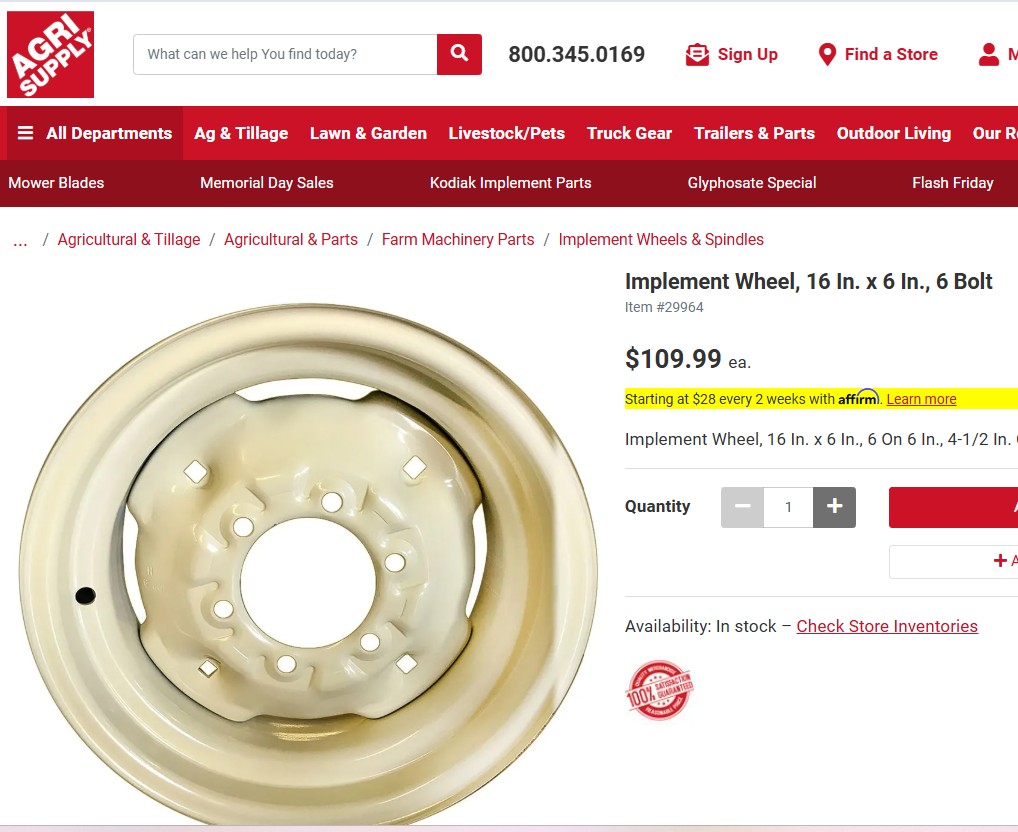

I need to upsize the front rims on my tractor. Originals are 4.5" wide and thinking I need 6.0" width. I changed front tires from 6.50", to 7.50" and used the original rims.
My original rims have a much heavier center to them than the replacements I've seen online. Also six welded webs to the rim opposed to four I've seen, and shown here:
I don't have a loader and not planning to install one, but do carry three suitcase weights always on the front and mow ditches, etc. I went with Firestone four rib, eight ply tires in F-2 pattern in memory serves and with the way they are "rounded" through the tread really cut into the grass upon turning. I'd like to flatten the tires out as they should be.
Anybody have recommendations to call for obtaining good quality rims? I'm not opposed to sending these to a place in California I've used in the past to make what I'm wanting; if that is the only option. They would reutilize the original centers installing with the offset needed.

most of the 6x16x6 rims are 2800# rated..... they alsos make a 3500# rim.. actually cheaper ??

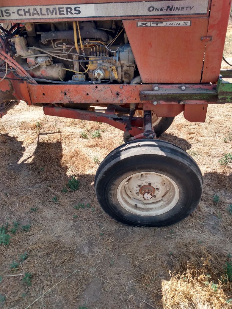

I just recently went the other direction - had 16 x 8 wheels with 7.50-16 tires on my 190XT, I bought a pair of 16 x 6 wheels (3500#) and the tires look much better on the proper wheel. The fresh paint looks a little nicer too. If the outfit in California that you dealt with before was Stockton Wheel I heard the building burned down and they didn't rebuild. Our current supervisor at work was the store manager at Stockton Les Schwab (tire store) less than a year ago, and Stockton Wheel came up in a discussion at work last week.

Hey Wheel ( DROP CENTER WHEELS ) has 16" x 6" - 3500 lb. rims for $95.

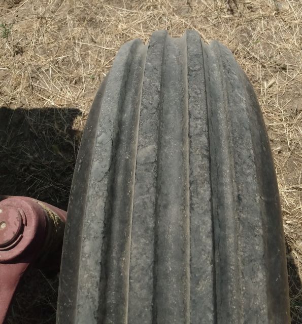

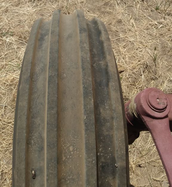

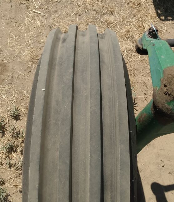

Hopefully I figured out this picture thing. I noticed a lot of difference in the four rib tire profile, took pictures this morning. Not quite a fair comparison, the Firestone is older and has some wear, other two have been put on in the last six months - in order Firestone, Crop Max, and Galaxy, all 10.00-16 tires on 8x16 wheels. I usually just get whatever is cheapest online, but I think I am going to start looking for the Galaxy when I order. Between my brother and I, we have four tractors that use the same front tire so I try to keep a spare laying around.

I went back and looked, my front wheels were through Quality Farm Supply, $93 each delivered. I"m happy with them, but mostly just pull a baler so I don't require much.

Izat a loader engine? Looks like my 545B.

Post Options Post Options   Thanks (0) Thanks(0)   Quote TedN Quote  Post ReplyReply Direct Link To This Post Posted: 5 hours 14 minutes ago at 12:34am
Honestly don't know what it is other than 2900 Mark II. It was installed when I bought it at auction 35 years ago. The hydraulic pump drive looks like it belongs on the engine, so loader would be my guess. Been thinking about starting a thread on it.
