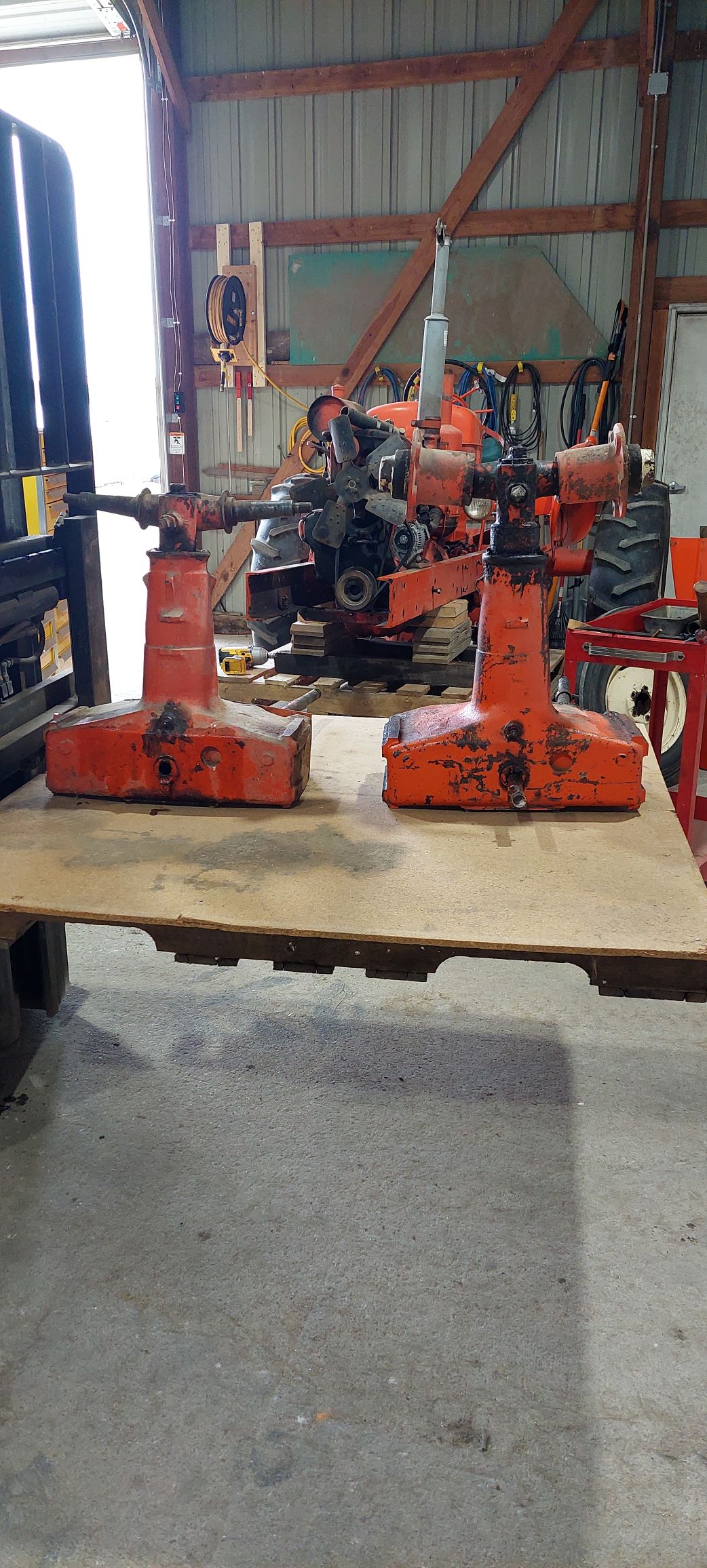

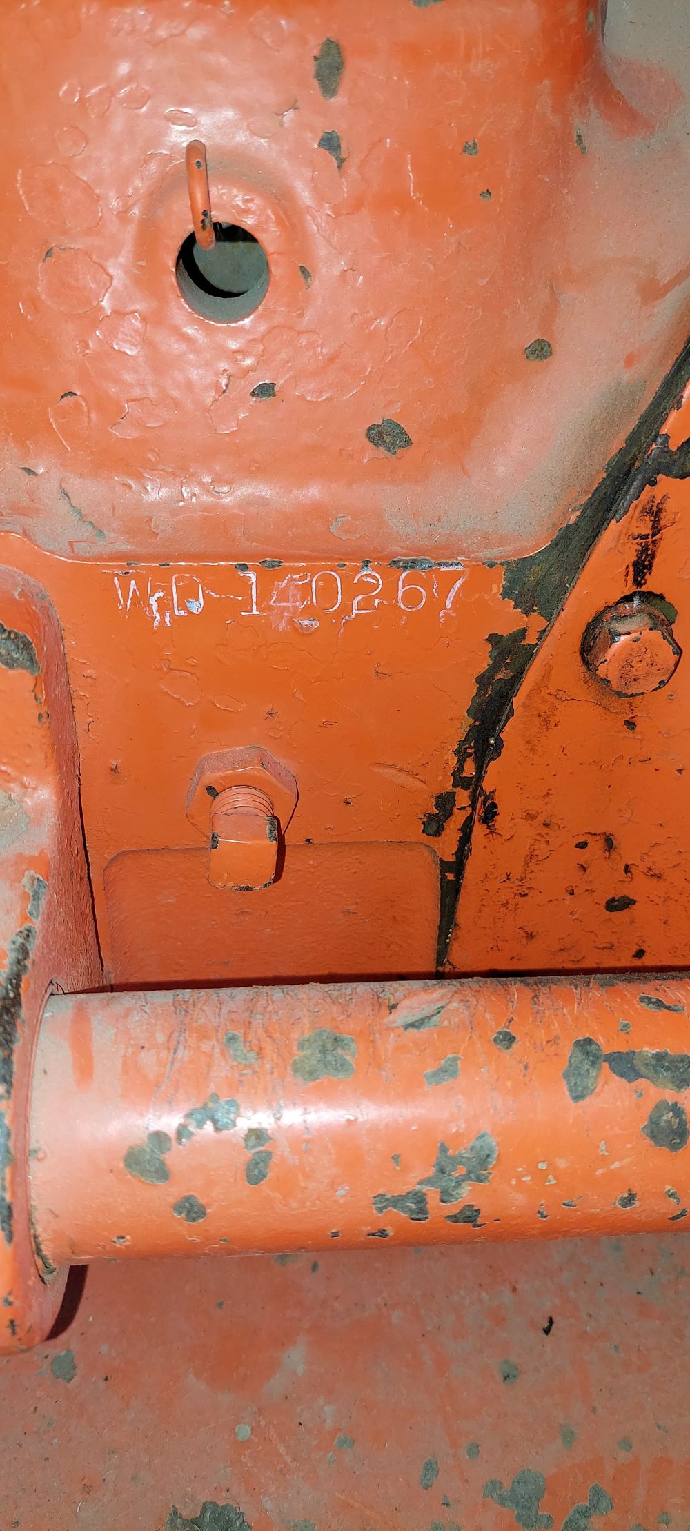

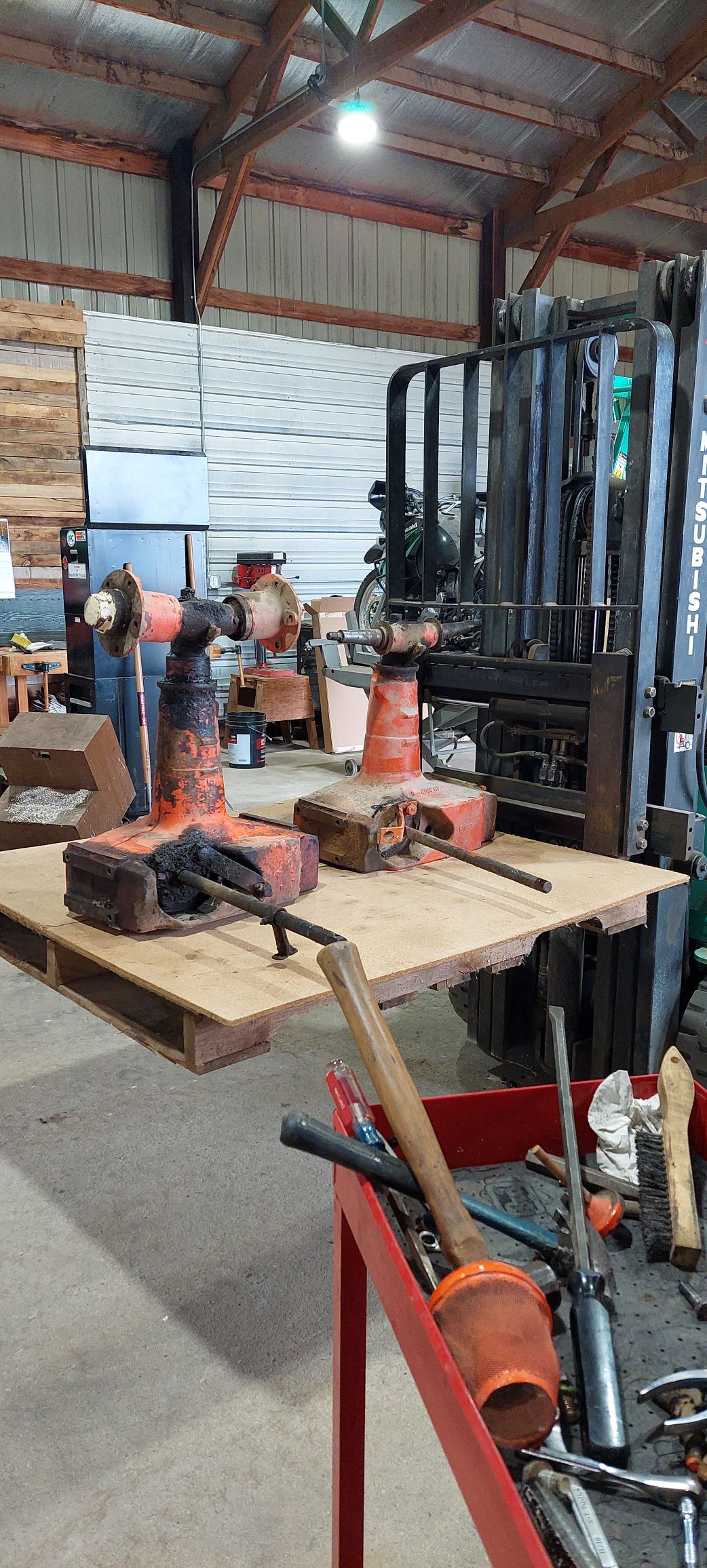

The pedestal with the hubs is my original, the other one is the replacement I bought from forum member mike,both from WD's,same casting #'s but cast in different spots.Don't know if I want to lower the front of my tractor that much.

Mine is a late WD,Is my original more like a WD45 pedestal?
53WD
Location: Jackson Cnty,GA
Points: 6608
Post Options Post Options   Thanks (0) Thanks(0)   Quote Hubert (Ga)engine7 Quote  Post ReplyReply Direct Link To This Post Posted: 29 May 2025 at 6:57am
Welcome to the Forum. Odd that they would have the same casting number unless the extra piece at the bottom is separate. The difference in height might not be that noticeable once you get it installed.
Points: 8970
Post Options Post Options   Thanks (0) Thanks(0)   Quote SteveM C/IL Quote  Post ReplyReply Direct Link To This Post Posted: 29 May 2025 at 8:08am
Something don't add up. I think yours has a spacer added at the bottom. Will have to look at mine.
Points: 22761
Post Options Post Options   Thanks (0) Thanks(0)   Quote DrAllis Quote  Post ReplyReply Direct Link To This Post Posted: 29 May 2025 at 8:31am
The short one is NORMAL. Yours ain't. It even has a longer shaft to match the added in spacer. maybe a Thompson Hi-Crop accessory ??

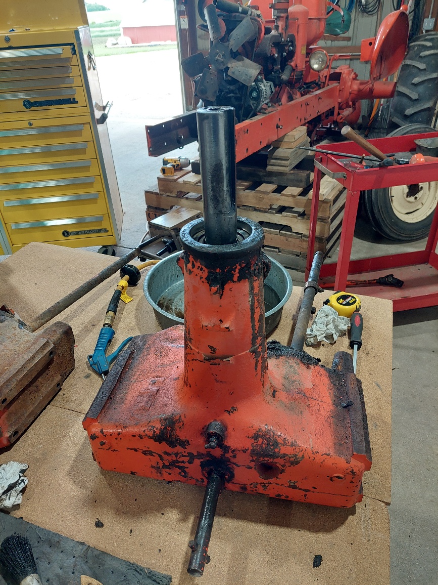

My original intention was just to do a swap, my wobbly loose, for Mikes much tighter pedestal.
Now I am curious.
Going to do some further disassembly on the long one to see whats up.If the parts are not to worn maybe swap the spindle blocks.
I was going to take that one apart to see how bad of a job it would be to put in a new lower seal. Practice before taking the one I want to use apart.
Maybe I have a super rare million dollar WD. I wish.

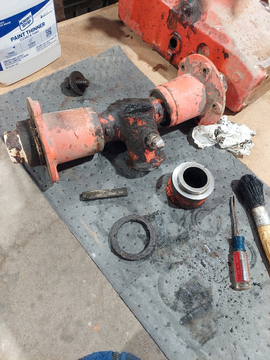

Here is the long one disassembled,spacer and a longer spindle shaft? there were no shims like the book shows
Edited by jmrehn - 29 May 2025 at 11:08am
53WD
Points: 5271
Post Options Post Options   Thanks (0) Thanks(0)   Quote PaulB Quote  Post ReplyReply Direct Link To This Post Posted: 29 May 2025 at 6:58pm
I'm throwing darts in the dark here: Is it possible that someone at sometime had reason the raise the front end and made a longer shaft and the spacer???

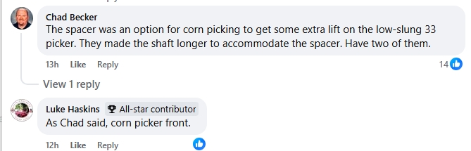

Originally posted by Lon(MN) Lon(MN) wrote:
I thought this was used on a mounted corn picker.
I posted the same pictures to a facebook Allis group, and several suggested that.

On the second picture, cart has air cleaner with attached screen, common for tractors that had the #33 Corn picker; ours also had the mud scraper on the front wheels.  R. Musgrave

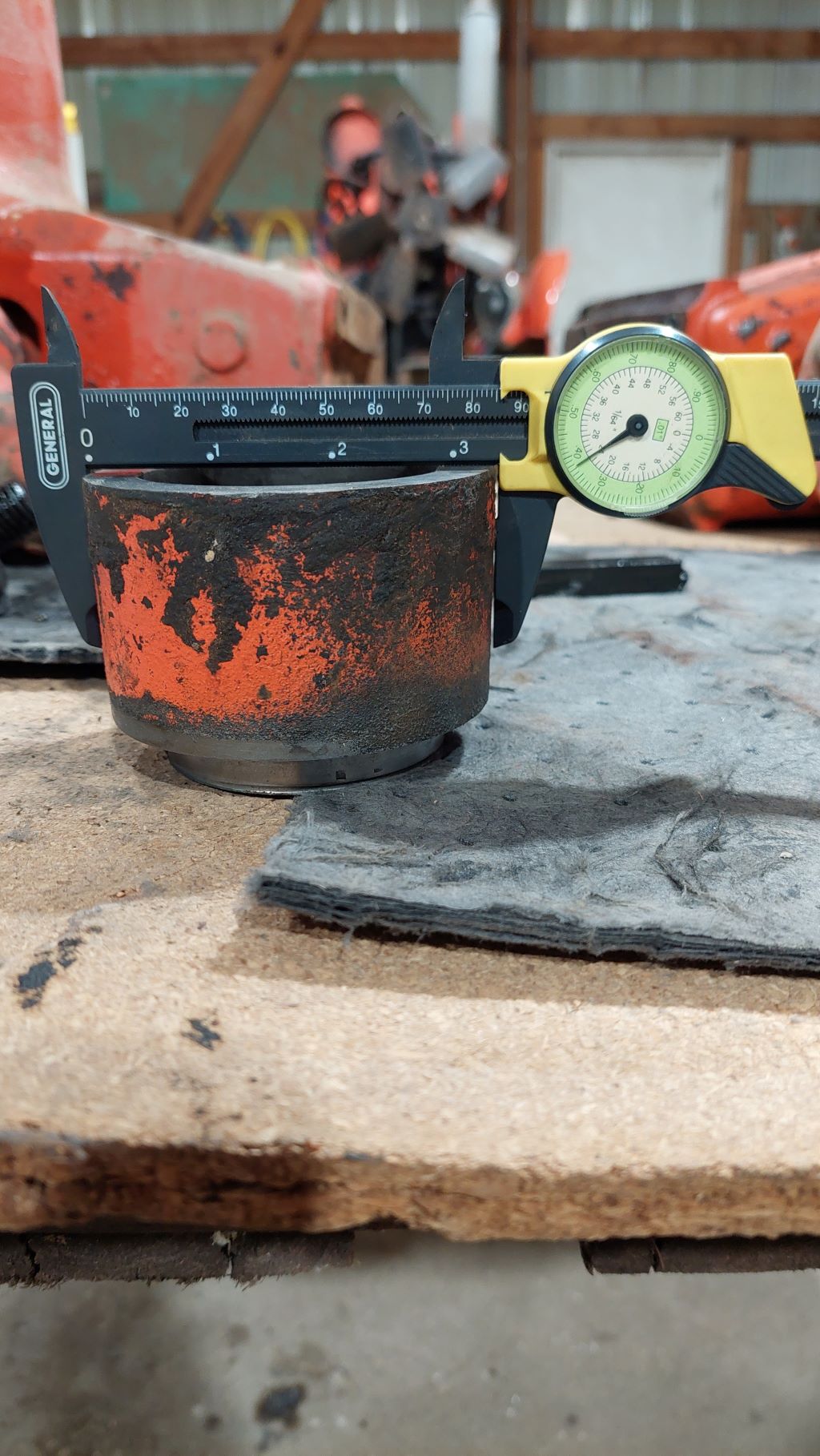

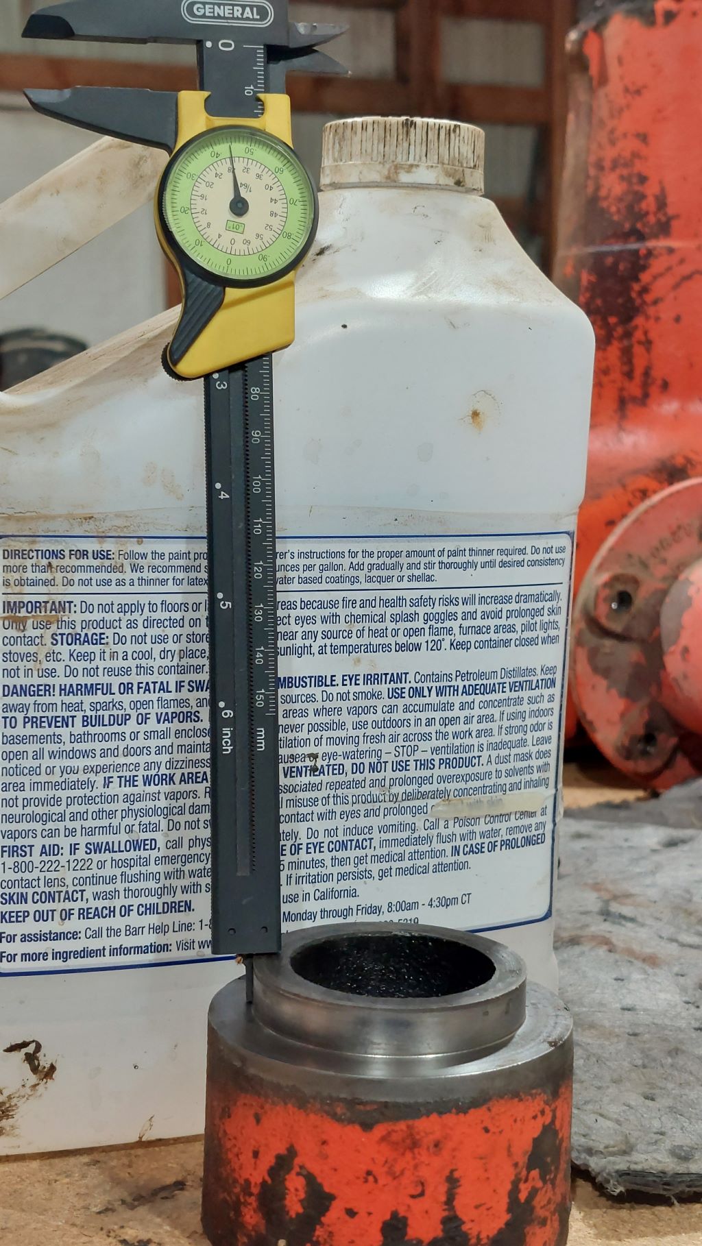

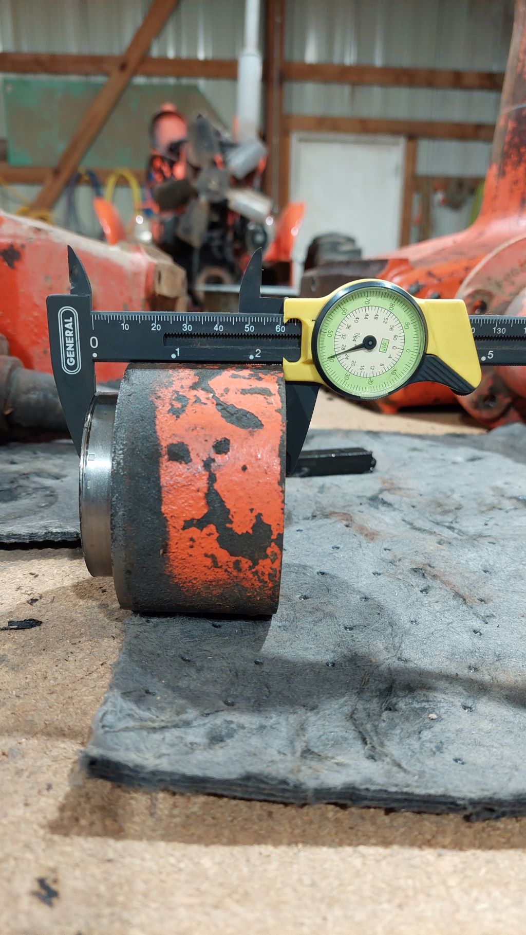

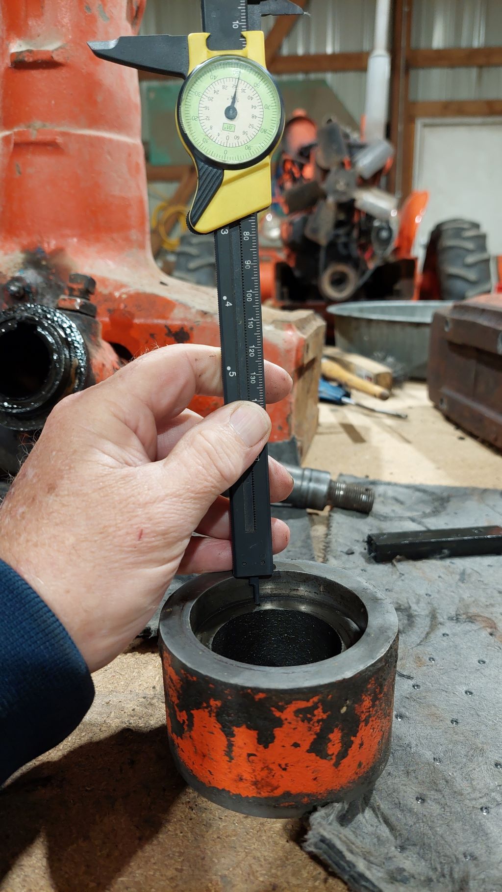

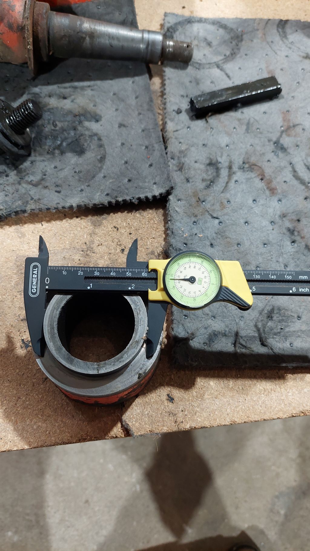

Any chance you could take some measurements of the spacer?
Height, diameters of inside, outside and step of the ledge.
I am assuming other side is flat.
I might want to make one for my picker.

Post Options Post Options   Thanks (0) Thanks(0)   Quote jmrehn Quote  Post ReplyReply Direct Link To This Post Posted: 03 Jun 2025 at 5:19pm

Post Options Post Options   Thanks (0) Thanks(0)   Quote kevin LA-CA Quote  Post ReplyReply Direct Link To This Post Posted: 03 Jun 2025 at 9:13pm
Jim
Super! Thanks for the great photo documentation.
I think I can turn one up.   Then extend the spindle for my picker.
