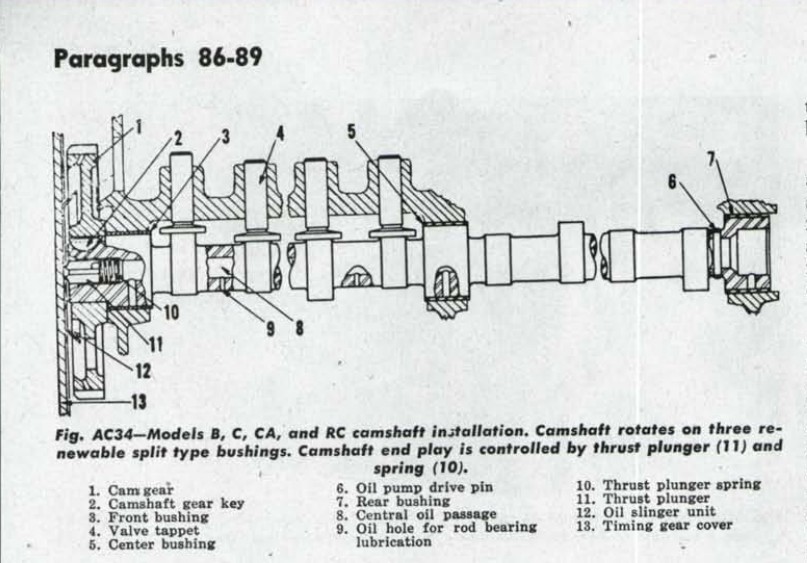

Post Options Post Options   Thanks (0) Thanks(0)   Quote steve(ill) Quote  Post ReplyReply Direct Link To This Post Posted: 14 May 2025 at 8:25pm
On the B-C engine, the hollow cam shaft has a restrictor plug at the front to keep the oil from dumping into the front housing on the gears.... Does the D14 engine have that same restrictor ? .......... Does YOUR engine have the restrictor in the cam ?
ITEM #10 - 11 ...

It does have the ball and spring in the front of the cam. I also tried the ball and spring out of the original engine because it looked to be in better shape.
Points: 22530
Post Options Post Options   Thanks (0) Thanks(0)   Quote DrAllis Quote  Post ReplyReply Direct Link To This Post Posted: 15 May 2025 at 4:49am
Ball and 2 springs and a plunger ??
Chilson450 View Drop Down
Joined: 03 Mar 2020
Points: 15
Post Options Post Options   Thanks (0) Thanks(0)   Quote Chilson450 Quote  Post ReplyReply Direct Link To This Post Posted: 15 May 2025 at 4:53am
There was a ball, 2 springs and then a 4 sided piece that the spring pushed against and rode against the front cover. I dont remember a plunger.
Points: 22530
Post Options Post Options   Thanks (0) Thanks(0)   Quote DrAllis Quote  Post ReplyReply Direct Link To This Post Posted: 15 May 2025 at 6:21am
You'e got it all.
