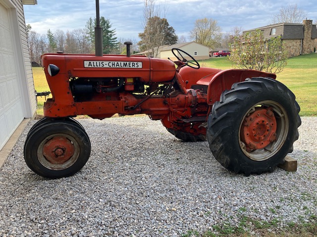

Nice looking D14, even better when the side shields and grill get put on. According to the decals looks to be a 1959 or 1960 black bar grill tractor?
Rick of HopeIN View Drop Down
Location: Hope, Indiana
Points: 1329
Post Options Post Options   Thanks (0) Thanks(0)   Quote Rick of HopeIN Quote  Post ReplyReply Direct Link To This Post Posted: 09 Nov 2024 at 2:38pm
yeah I hope to get back to it in spring and do some cosmetics.  I have the grill and side panels, I just did not hang them back on.  The decals are wrong, it should have the 57 decals.  I have a wide front for it but have not got around to swapping.  This not the same tractor but it is like the last tractor they kept around when they closed down the old family dairy farm.  My cousin actually found the original one but it was in pretty bad shape.  The old Wagner industrial loader with oversized bucket was hard on it.  The picture shown is me on it when almost new.  Wish I had the old Cockshutt in background also.  Truck beside it is a 57 Chevy Viking single axle that was on the road into the 80s.
