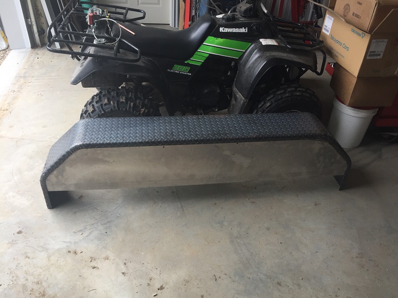

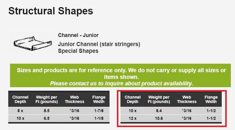

I have a 10 year old 18 ft 10K car hauler. Old sheet metal fenders have seen better days after hauling backhoe , bobcat, connex boxes... Pretty beat up. I had considered buying fenders made of 3/16 inch plate but they were around $500.  I thought of making fenders from 10 inch c- channel, but they would be pretty heavy. While checking around i ran across something called JUNIOR CHANNEL.  This was a 10 inch c- channel with 3/16 inch thick web and slightly thicker flanges. Weight was 8.3 pounds per foot .. so a 8 ft long section welded into a fender shape would be about  65 pounds per side.. PERFECT..
I bought 20 ft at the local Steel Yard and it was around $200. Didnt take long to cut the three pieces to make a fender with flat front and rear edges. I had a few scraps of 3/16 inch deck plate which i used to fill in the opening at the trailer deck... Getting the old fenders off was the biggest problem !!

 Well, Steve,,those look Great and no doubt will withstand a lot more punishment that all trailers that get regular usage will. I always shudder against that first dent with a new trailer ,,,,and after that first dent,,,,wwell,,,all them other dents come way too dang often,,,,WinkWink
 Good Job,,,,!!Clap

yea... had a few dents.. then SON dropped a 20 ft connex box on the fenders and smashed one down to the tires... had to use a bottle jack to get it up high enough for running clearance.... NEW fenders should take as much load as the tires can support !!

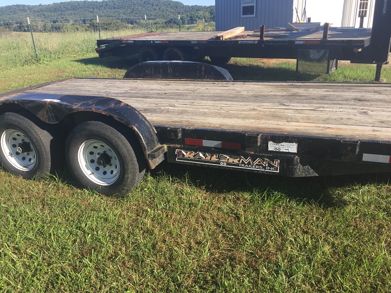

Bought this trailer used several years back, is due to repaint currently as time does not wear well.  It also had the Tin Soft fenders where I added Tread Plate replacements from a Trailer Supply company.
Found them on a search for trailer fenders and were a direct install to OE Mounts.  Standing up really well for beatings I have given.
