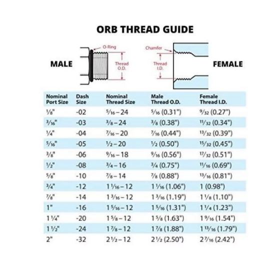

it is probably a BOLT thread..or SAE plug size ... If you measured with a MIKE and get the thread pitch, they do sell adaptor plugs. Edited by steve(ill) - 22 Jun 2024 at 4:42pm |
steve(ill)
Joined: 11 Sep 2009 Location: illinois Points: 90733 |
Post Options
Thanks(0)
Quote Reply
Posted: 22 Jun 2024 at 4:46pm |

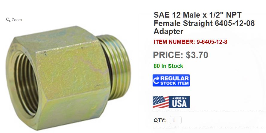

im not saying it is a -12 fitting ... but if the OD of the plug is 1- 1/16 inch ... then something like this should fit.. ( 12 threads per inch)..
