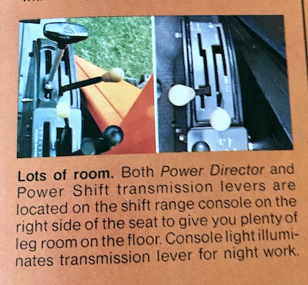

[/QUOTE] Which brings the question....What exactly is the difference between a power Director and a Power Shift?  How do they differ in operation? [/QUOTE]
20 speed PD has;
5 gear trans x
2 shift Range (Slow/Fast) x
2 Foot floor buttons(Low/High).
16 speed PD has;
4 gear trans x
2 foot floor buttons(Low/High).
12 speed PS has;
6 gear trans x
2 shift range (Slow/Fast).
Both PD require foot clutch to be disengaged to shift both Trans & Range. Floor foot buttons are “on-the-go” shifting(no clutch). Floor buttons are usable in every gear/range, so extremely convenient for slower headland(turnrows) maneuvering. 16 speed was standard. 20 speed was optional.
PS’s trans gears 1-6 can be shifted “on-the-go”(no clutch). 2 speed range shift requires foot clutch disengaged. Operators right hand can quickly move 6 gear trans lever between desired speeds.
Heres a photo of each trans console. PD is on the left. PS is on the right.
Both trans have a Range shift lever on their right sides (Park-Slow/Fast).
PD's T-handle can twist&To-Fro for selecting 1,2,4 forward, 5,3,R rearward.
PS's lever moves forward 1-3, then 4-6 & moves back for R.
All the 7010,7020,7030,7040,7045,7050,7060,7080 models have Rear-end Differential Lock as standard equipment. Don't think the 7000 offered it?
Edited by AC7060IL - 12 Jun 2024 at 9:29am
