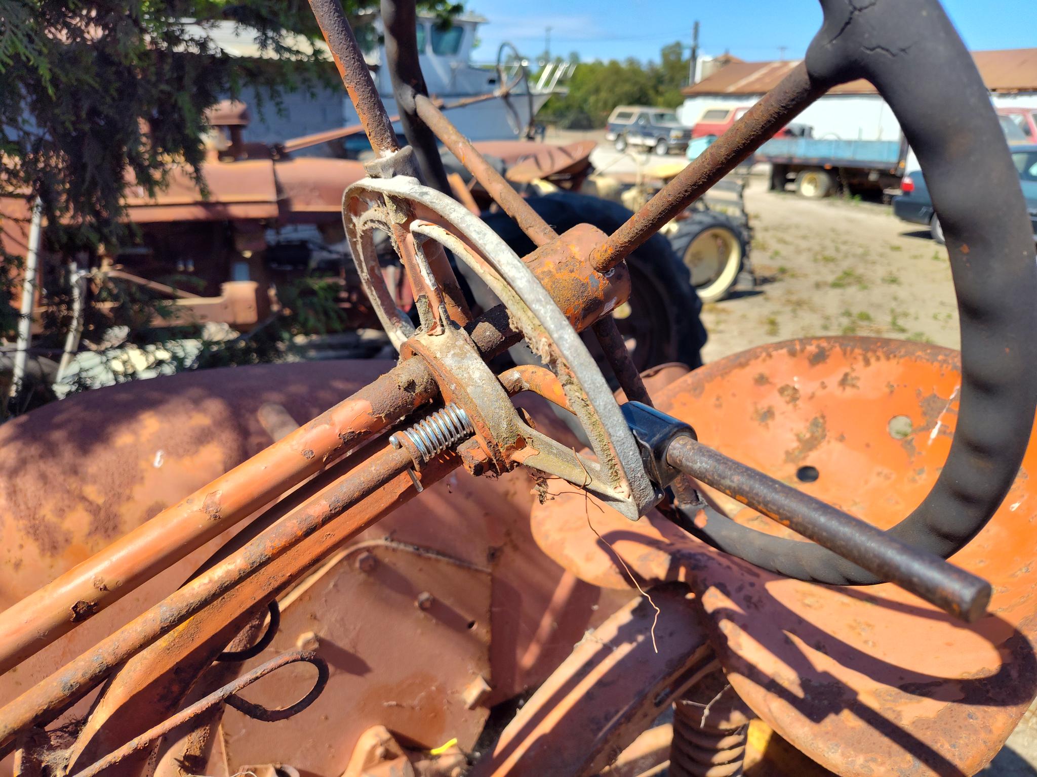

The hydraulic lever on my new WD floats up to the 1/2 position. Naturally the lift arms move up as a result. I recall dr Allis said to make sure the spring to the traction booster control linkage was in place. I put the spring in, but no help.
This tractor has a early after market 3 pt, and no drawbar. I wonder if the traction booster linage is wonky.
Bought a new friction block for quadrant and backing spring is ok, but not sure if that will work.
What else should I look for?

Worn friction blocks, broken tension spring (usual suspect) or a broken quadrant itself.

Sometimes helps to oil spring at quadrant. They tend to wrap not slip and pull lever.

Make sure the lever has a 90 degree bend. I ran into one that was off a little and did not have the proper tension on the friction block. Guess it got hooked onto something. Also, friction block worn, but most likely a broken tension spring will allow lever to drift.

Dr. Allis nailed it. Broken spring. Also replaced friction block.
