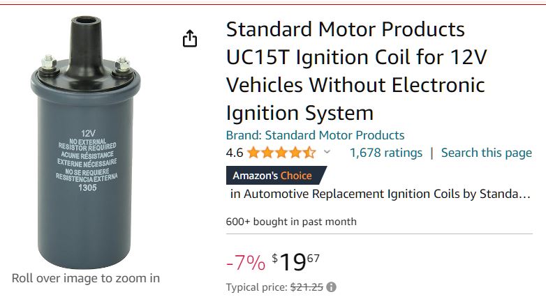

YES... there should be a lable on the coil that says " 12v with internal resistor" . ... not really an actual resistor, but wound for correct resistance.
Points: 90746
Post Options Post Options   Thanks (0) Thanks(0)   Quote steve(ill) Quote  Post ReplyReply Direct Link To This Post Posted: 01 May 2024 at 1:16pm
this one actually says "no external resistor needed" on the case... AMAZON
Fred in Pa View Drop Down
Location: Hanover Pa.
Points: 9210
Post Options Post Options   Thanks (0) Thanks(0)   Quote Fred in Pa Quote  Post ReplyReply Direct Link To This Post Posted: 01 May 2024 at 1:37pm
The UC 15 T is a    3 oem    resistance    coil  for  any  4 cylinder  engine   12  volt system
